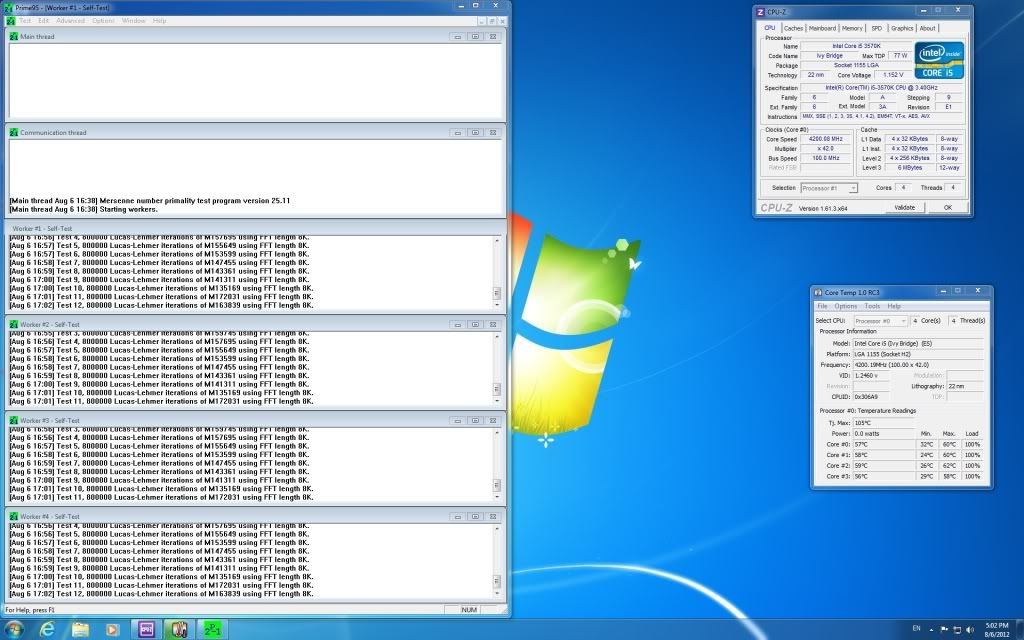

Take a look at this.
That's a screenshot of my own OC, and as you can see, Windows still says that the CPU is at 3.3Ghz, when CPU-Z very clearly shows that it's at 4.5Ghz. That's just an oddity of how Windows reports CPU speeds for Intel CPU's. It's not a problem at all though, since it IS very obviously OC'd.

What I did was pressing F5 and setting bios to optimal defaults.
Then I went back to Ai Tuner/Tweaker and set to XMP profile.
Then I went to CPU power managment and set the Core Ratio to 40. ( I couldn't do it with mouse, it was stuck on auto, I had to press + until it reached that).
Now I think that sync thing was enabled, all cores run on 40, but the result on the upper left corner of the screen in yellow writing says:
"Syncronized at.....CPU 4000 Mhz, 1600 mhz RAM"
Under minimal work, CPU-z shows my core speed to be 4000 mhz (idle is 1600) and when I check the memory, DRAM frequency is 800 steady.
Did I do it right?
I ran over an hour and 15 minutes of Prime95 on the heaviest test (the blend of RAM and CPU). 89 tests, 0 errors and stops. core temptures of all four were below 60 at all times.
Did I do it right?

Hey something weird happened!
After succeeding with the 4.1 ghz OC, on -0.025 offset. I tried setting my Core Ratio 42 and start the system.
Now I check with CPU-z and see that my core speed is always 4200! and voltage always on max! so basically it never enters the idle state, even when I'm on desktop and do nothing.
What have I done wrong? what should I do to fix this?

Ok EDIT: it's not like it doesn't enter 1600 mhz idle state at all, it simply doesn't do that as frequently as before. When I startup windows (and it doesn't take much time) and openup CPu-Z I see that the core speed is 4200 and voltage 1.160. After rather long while it drops to 1600 mhz and voltage under 1.00.
