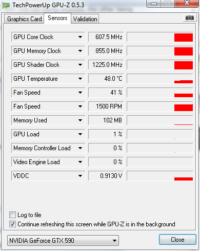

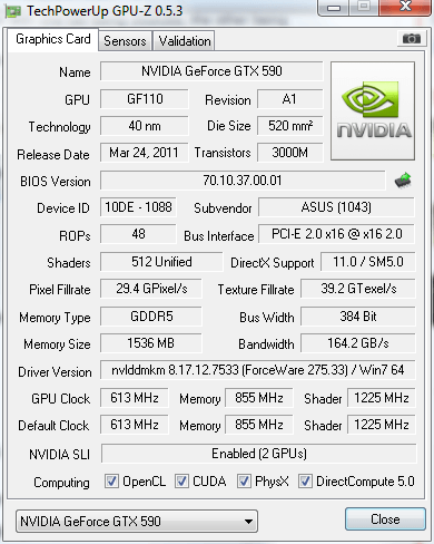

Again, those were THEIR results. I downloaded GPU-Z 5.0.3 (the most recent version) and these are my results
Asus GTX 590 video card GPU-Z details
Asus Gtx 590 video card idle stats
So as you can see.. The details of the video cards are the same, but the Idle temperatures screen is abnormal on mine compared to theirs.
I took those two screenshots with only the internet open with one tab being youtube, the other being legitreviews.com and the other being this site.
Why are my video card specs so abnormal? someone please help :(

I dont think the stasts are out of normal apart the temperature that it is a bit high the rest are ok.In thhe results you took from the web the gpu is in absolute idle and has drop down its clocks to save power,as my 560 hawk does from 950mhz it has two scales,one at 405mhz and in absolute idle 51mhz so here it is happening the same thing.If you want install this gadget and monitor your card i have it also and it is great.
Even when you think you are in idle mode, certain internet webpages may have Flash based graphics which may cause the GPU to kick into a higher performance mode. Windows Aero interface sometimes causes it to kick in as well.
I am a little puzzled as to why one screenshot shows 613 mhz and the other shows 607.5 mhz. You should download Afterburner and use the graph that shows your core speed and follow that to see if there is truly something amiss.

No from what i see(temps,fans speeds)its completly normal.You can also see what i was telling about the power saving on my hawk,it is also hear with the core clock at 51mhz if i am not wrong the memory clocks must be at 135mhz when core is 51.So dont worry about anything.Also give as a screenshot of load state.

This goes for all video cards. When using 1 card with more than 1 display it forces to 3d clocks.
On the GTX 590 once u have ur chipset drivers installed which will detect gpu #2 after u install chipset sli drivers.
Then plug 1 monitor into gpu #1 port, and plug another in gpu #2 port.
If your running 1 display then I'd say wipe drivers with DDU in safemode. Restart, let windows do it's thing, restart again. Then you can install new drivers. Install drivers, restart. Now check your clocks, if viewing in gpu-z at first will clock to 3d but auto-down clock after a few seconds if operating normally.
Otherwise I'd say bios flash it. Mod the volts to be the same on both gpu(s) at say around 900-925mv or 0.900v or 0.925v. If you need precise help I can do that.
