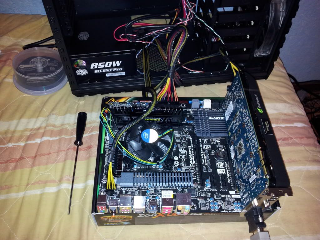

This is my first build ever, i finally got the money and parts
after reading countless guides ,tutorials, etc.... i was confident everything would be right..
I even followed step by step, Newegg building a PC video tutorial (#2), so i made first an external build test (like the video) to see first if it would boot... i only used the power supply, memory ram, video card, motherboard, and cpu, no other components were attached..
And in the end, it didnt worked......... its just sad.... I short the power pins of the mobo with my screwdriver, i dont hear any sound and nothing works, i just see a 0.5 or less red-green led flash blink.... and thats all...... if i do it again, nothing happens, not even the blink, i have to unplug the cable from the power supply and plug it again.... no beep, no post, no video, no nothing......

Took them with my cellphone
From the front
From the back

Theres a possibility your shorting the wrong pins. Id recommend build everything properly, in the case, connect everything up and then try and boot.
Make sure ALL the motherboard power is connected, (24pin and 4/8pin).
Make sure the motherboard isnt shorting power - make sure standoff screws are all correctly placed and the motherboard is properly attached.
Have you connected the speaker to see if any beep code errors are generated?
Your video was a little dark, but i noticed a stick of RAM on your sofa next to the build? Has the motherboard actually got some RAM installed?

yes, i tried first with the 2 sticks, then i remove 1 stick...it has one installed and also i tried on every ram slot with no success..
im shorting the PW pins (2 pins), the mobo manual says that are the power pins
i put the mobo above its own box (newegg recomendation), so it cannot be shorting... it has no metals around
I have the speaker connected.... just nothing happens

from the video and pictures you need to connect the second 6pin molex power plug for the video card. the video card needs to have 2 6pin molex power to the video card for it to work.

August 26, 2011 10:31:13 AM
mmmm really?? but the other connector just doesnt fit... i read many video cards just use 1 connector, i try to connect the second one, but it does not fit anywhere

Anonymous
August 26, 2011 10:41:59 AM
the video card could be 1 6pin and 1 8pin or 2 6pin molex, depending on the video card. Both power connectors should be plug in to the video card.

August 26, 2011 10:47:02 AM
i just re-checked it and its impossible, it has different shapes as the connector (right one), only the left one can be connected, the right one, cannot be conected in any of the 2-6pin.....
Also, the connectors are only 4 pin

Anonymous
August 26, 2011 10:58:51 AM
your video card should come with 2 4pin molex to 1 6pin molex adapters in the box, in case your power supply doesn't have enough connectors for the video card.

August 26, 2011 11:12:06 AM
Actually its not the GPU that should have the cables.
Your PSU should come with another cable with a 6pin connection on the end, exactly the same as the one you have already plugged in. You need to plug in 2 6pin power cables to the GPU. (this will be one of the modular cables).
If you have any 8pin cables, they are also more than likely 6+2 pin and so the 2 pins will unclip leaving you with a 6pin connection.
http://www.coolermaster.com/product.php?product_id=6627
If you scroll right down the page it shows the cables supplied in the box. You need the PCI-e 6+2 pin one and unclip the extra 2 pins leaving 1 6pin connector. Plug this into the second GPU power slot.

August 26, 2011 2:14:55 PM
thanks a lot for your help... well i think we got step further, but is not yet working...
i think it has now a boot loop
look
http://www.youtube.com/watch?v=zMIljFdWnjo
It just starts, led flash blinks (cpu fan and video card fan start now) for about 1 second, then turns off, the again after 3 sec more or less, it start again in its own....... it doesnt reach BIOS
and it never appeared something on the monitor and no beep.... this is with 2 6 pin connected
if i try 1-4pin (first post) and 1-6 pin = same problem as first post
if i try 1-6pin only, (in any of the 2 connectors), i get the same problem as this video i uploaded this post, just that it seems cpu fan and video fan start to run with more power than in the video

August 26, 2011 5:54:59 PM
Well... i did a PSU test, so i disconnected all the power from the MOBO, and connected just a fan to the PSU, then i short the green and black pins... and the PSU worked:
http://www.youtube.com/watch?v=77UTE8OMgIU
then i connected the power from the PSU again to the MOBO, and i dont know why, it finally booted!... i had no signal on monitor (dont know why) and the beep sound was a long one... and the cpu and video card fans were loud :
No Video, Loud fans, long beep:
http://www.youtube.com/watch?v=wHLvsvLGpkU
Then i disconnected the monitor, and connected the mobo to my 55" samsung tv via HDMI.... no video..... then i connected it again to my TV but now using VGA (as with the monitor). and it worked!!! Now i had video on screen, normal beep, and fans (CPU and video card) were nothing loud (i dont know if this is good...), like if they were off.... no sound at all (but they were spinning)
Video, fans didnt made any sound at all, normal beep:
http://www.youtube.com/watch?v=N9OlVs0vXsM
So... what do you think??? i dont why or what happened..... but now it works... something i should be concern of?? Im not really sure
