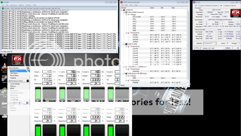

I guess my question is.. how do i stop my processor from going into idle...ive disabled all the normal things in the bios that do this and enabled LLC.. i play crysis and my framerate drops from 112 fps to 23 during the voltage drop.

Ok so since ive built this pc this issue has been going on. I cant play any games bcause of this drop in the multiplier and voltage. I Just would love to run it at any frequency steady and stable... and yes i have amazing cooling. Gpu 29c. and my cpu at 4.5ghz is at 41.3c

ok i am using a enermax t-40 Heatsink. and yes a re seated and re applied paste and yes i removed the plastic the room temperature in my room is 68 F and right now it says my cpu is around 40c during crysis. the voltage is litteraly half of what it should be. Please Keep replying your input means alot

ok do you know what could be wrong anything i could try ?? any screen shots you want ?? my system specs are
7850 0C 2gb Gddr5
fx 8150
990fx extreme 3
8gb g skill memory

Download Hardware Monitor. install and run it while trying out a game. it will tell you minimum and maximum temperature and voltages. just check it after tyring your game and post for CPU and GPU. MIN and MAX for both.

prime 95 tests passed. im never had this problem in any of my builds .. could it be a faulty motherboard sensor causing the cpu to throttle unnecessarily
Well, I'm almost positive that the temp sensors aren't right, so it's possible.
It still wouldn't hurt to try doing what Rick suggested, though. Definitely try HWMonitor (or even SpeedFan, even though I hate it, but it seems to work for AMD CPU's). They probably won't give you the correct core temps, but the CPU temp was close to right with those for another person I helped with unrealistically low temps.
