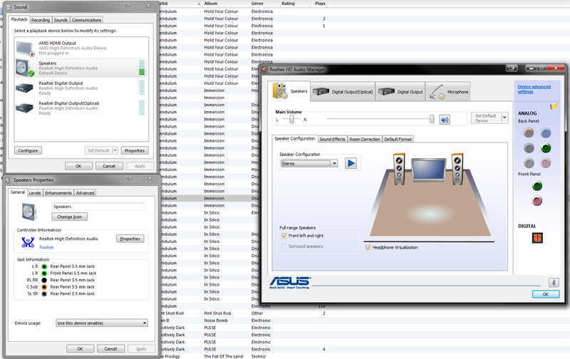

January 3, 2012 1:19:54 PM
The sound settings lists all of the jacks. Here's what I have at hand, I'm sure someone can figure it out...
m
l

January 3, 2012 2:03:29 PM
You should be able to do it via the Realteck Audio Manager, though I would imagine the jack sensing would do that for you...
m
l
January 3, 2012 2:12:07 PM
Yes, it will play sound through the headphones, but even if I check "mute rear output if front heaphone plugged in", it won't mute the speakers, but will still play through headphones..
also helps to note that the headphones ARE SET to be the default device.
m
l
