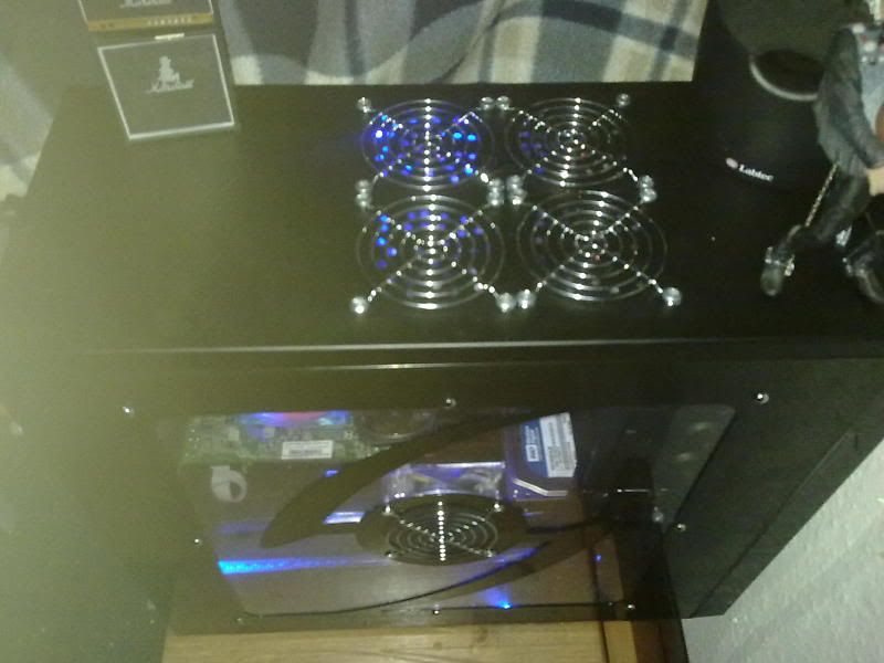

and heres my method for four 80mm fans in a roof
it all depends how much time/effort you are wanting to put into this and how 'cool' you want it to look
Moto

Heres my top mod.

Cheers Bro, I didn't have time to go trawling and find a pic :)
Btw Op, we both used the same case there
Moto

Kind of wishing id never sold that case mod.. :(

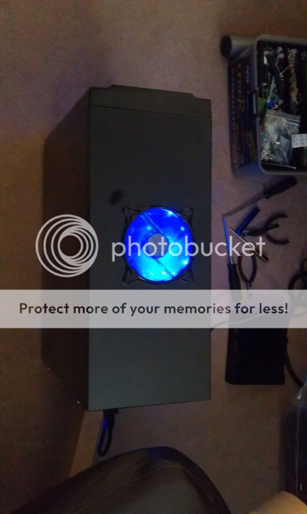

The design works very well indeed using the heat rises principle and also by achieving +ve cool air pressure inside the case, so you have 2 x 120mm fans at the bottom of the case drawing cool air in and up over all the components, also the side fan blowing cool air straight onto the GPU, then you have the cpu fan and rear case fan exhausting hot air, with the top fan exhausting any hot air lingering at the top of the case.
The proof is in the pudding, i managed to have a 955 x4 in the rig OCd to 3.8ghz, idling at 22c and only 52c on small fft test after 6hours, ambient room temp of 19c.
a b ) Power supply
January 13, 2012 10:16:06 AM
Remember the issue on this case is that it has not front intake fans, or space for them so i had to mod the case so it was like a chimney, cool air in at the bottom hot air out of the top, pretty much stole the idea from Silverstone cases.

AHA, thats because you have not seen the under side yet, here you go, notice ive used aluminium drawer knobs as the feet which gives 4.5 cm clearance from the ground plus the fans are filtered to stop them acting like a vacuum cleaner.
