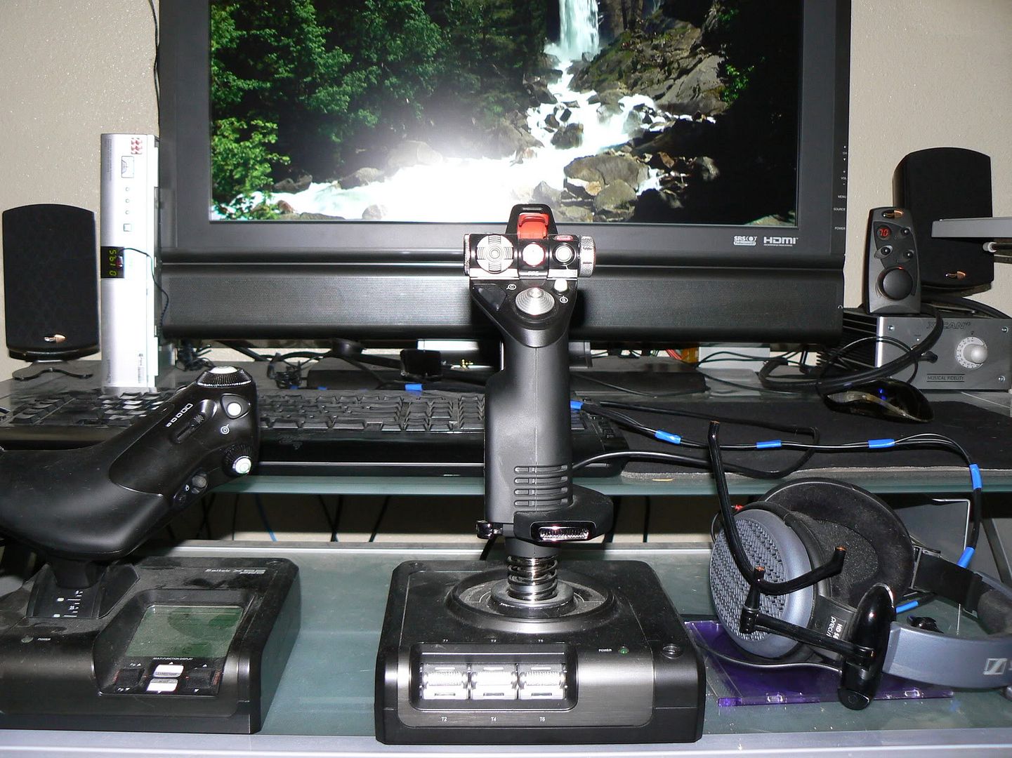

I use the Musical Fidelity XcanV3 with a tried and true set of HD580. A basic radio shack headphone will suffice, though the dynamics that a tube adds to the game is just incredible. :eek: This isn't coming from a noob either, been using TH since windows ME (ACK)....sorry, just vomited in my mouth. Just hadn't used my account in a few years.
Open dynamic are perfect for gaming...especially first person shooters. I use the ever so ancient klipsch promedia 5.1 thx when I absolutely have to have surround (tournaments and clan gaming)...but even still I noticed the impedance of the hd580's combine with the power to push them results in subtle sounds that you just can't hear from a loose cone or one of the micro cones in these 5.1 headsets. All of those brands made me :pt1cable:
