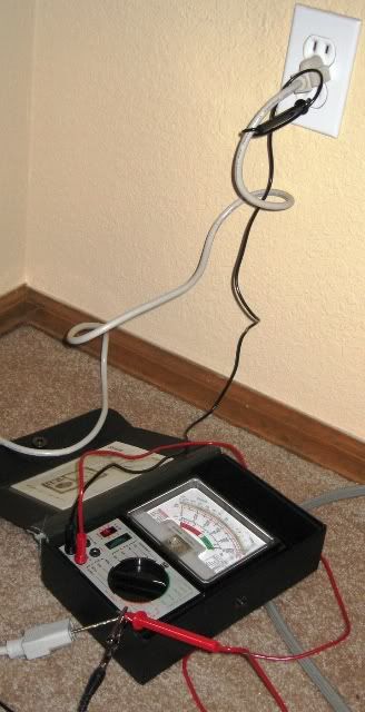

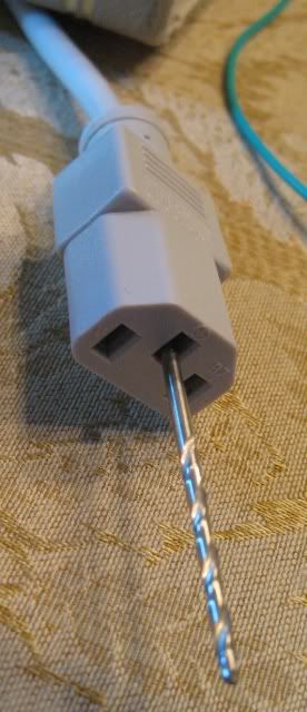

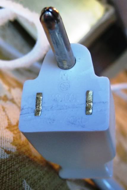

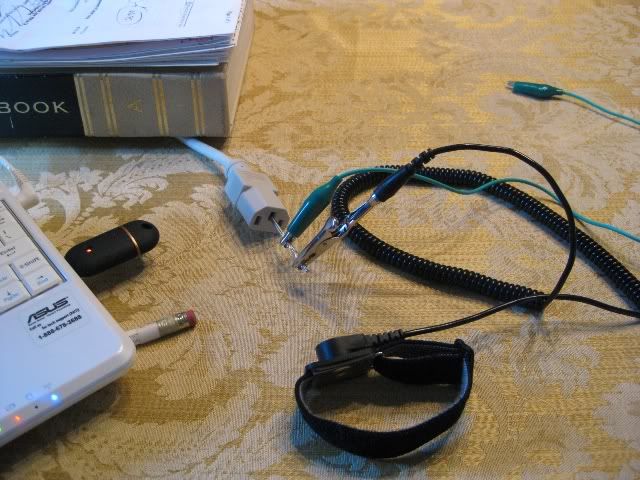

I live in the U.S. and my house's electrical system is grounded in accordance with the 1995 US Electrical Code. Being the skeptic, I tested the wall socket I'd be using with this little Ground Tester I had out in the garage, and all was copasetic.
Does anyone think I'll fry my new computer if I connect the ground lead of my wrist strap directly to the ground receptacle in my wall outlet?

In any event, as I stated in the OP, I tested the ground circuit of my house with the above-mentioned tester. I also tested the voltage between the neutral circuit to the ground circuit with a VOM and found it to be 0 VAC.
I'm pretty certain that the ground circuit in my house is safe and stable. If it wasn't, I'd face a similar risk on everything in the house that has a case ground.

Like I've said before, I would just feel a lot more comfortable complying with the spirit of the detailed and specific manufacturer instructions that came with my wrist strap. I'm anal in lots of ways.....which, in my case, is a good thing, since I should have been killed many times over by now in my life. My anal approach to many things is the only reason I'm still here.......I'm absolutely convinced of that!
I want to use the wrist strap, and I want to ground it using the safest and most conservative method that is reasonably available to me.

Everyone has at least one old PSU power cable lying around. I grabbed one and removed the two power prongs using a hacksaw:
This step was not absolutely necessary, but mitigates a few major hazards for very little effort expended.....a good tradeoff, IMO!
Next, grab a small drill bit (a 3/32” drill bit worked perfectly in my case) and push it far enough into the other end of the now-modified power cable such that it makes contact with the ground lead:
It is a good idea to check that your connections are good. Grab you a VOM, set it to resistance, plug one of the VOM’s probes into the ground hole of an outlet, and plug the modified end of your power cable into another outlet’s (that is on the same circuit) ground hole. Finally, contact the drill bit with the VOM’s other probe. The VOM should indicate continuity. If it does, then you’ve got a good setup:
Here is a shot of the grounding point I used during a recent build. The black clamp is connected to my wrist strap and the green jumper cable gets connected to the computer case:
And, there you go. Both you and the case are “one” with a common, huge capacitance ground!
