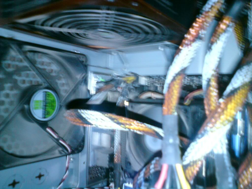

PSU:
http://i672.photobucket.com/albums/vv88/Ashrafoni/DSC00116.jpg
Voltages:
http://i672.photobucket.com/albums/vv88/Ashrafoni/DSC00117.jpg
Reply to RVG90

Ok, so your voltages seem to be mostly in check in bios, you have some really strange board readings in windows.
The CPU vdda seems off to mean as i never messed with it, but it may be a high, the cpu vcore can be lowered to 1.3 at stock i'm sure, that will make your chip much more power and heat friendly, just test with prime after to make sure it's a stable undervolt, if not touch it up a step until you no longer get errors. You won't damage anything by undervolting so you don't need to worry about that.
The ram voltage is a little high for stock, whats your ram's rated voltage and timings? You should set ram to what it's rated for unless you plan to overclock.

I have a question that might be a bit stupid, is the fan that's located in the back of the case under the power supply, is it supposed to pull air in or push air outside the case?
Reply to RVG90
If you are talking about a fan that's part of the power supply, it pulls in cold air to cool the psu and exhausts some of it out the back, now if this is a fan on the case that all depends, if its on the bottom of the case it should be an intake, top and back fans are usually exhaust as heat rises.
------------------------------ Sentey Optimus Extreme | OCZ ZX 850 | ASRock 970 Extreme 4 ASRock z68 Extreme 3 Gen 3 | PII b20 x4 @3.5ghz i5 2500k @4.5ghz | A70 | 8GB G.Skill | Solid III | 6870 |
H61m | Celeron G530 | 4GB GSkill | Antec 520w | 6790 |
Reply to omega21xx
- 0 +
I got 3 fans in the case, 1 in the power supply, 1 on the processor and another on the back of the case and i am talking about the last one. there is 1 screenie of what i am talking about:
http://i672.photobucket.com/albums/vv88/Ashrafoni/DSC00124.jpg
Shouldn't there be at least 1 fan taking the heat outside of the case?
Reply to RVG90
Yes, that fan to the left on the back of the case should be an exhaust and the power supply one can be ignored. Same with the CPU fan. You don't have an intake fan for cool air it seems.
Reply to omega21xx
- 0 +
Yea the left on the back is taking air in and nothing is taking it out.
Also can the position of the case affect it?
http://i672.photobucket.com/albums/vv88/Ashrafoni/DSC00122.jpg
http://i672.photobucket.com/albums/vv88/Ashrafoni/DSC00121.jpg
That's how i put my case..
Message edited by RVG90 on 02-20-2012 at 12:38:43 AM
Reply to RVG90
