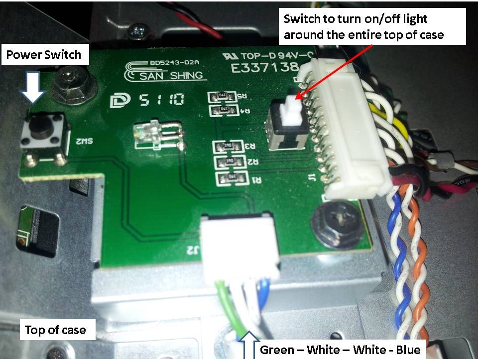

I traced the Green-White and Blue-White to the top of the case and here is a picture. There is NO Reset Switch (this is confusing me) on the case! Here is the top of the case:

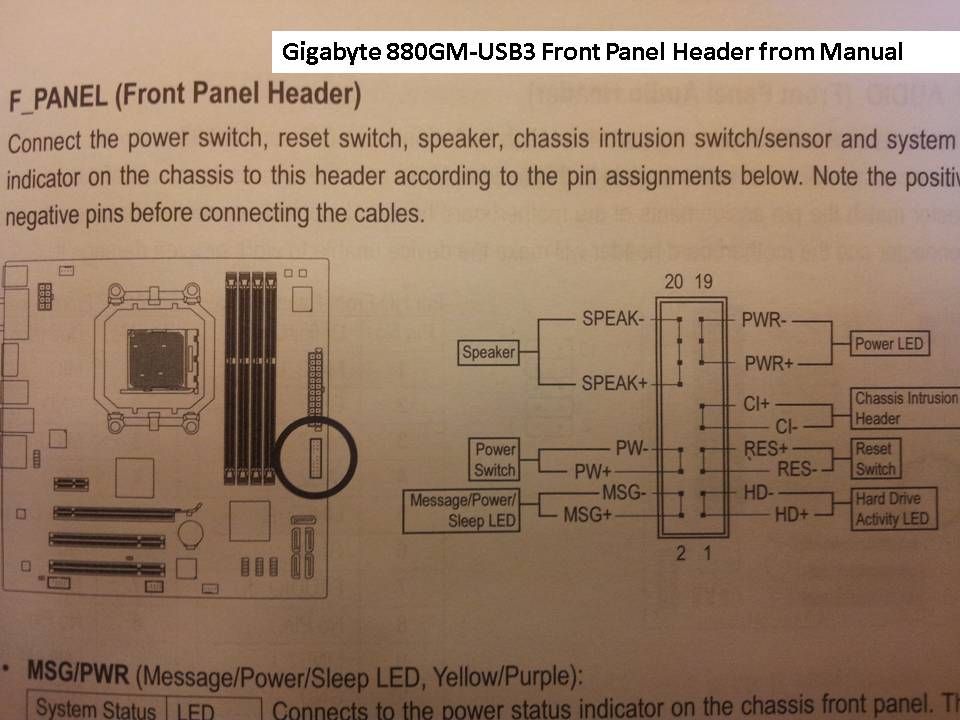

Here is the diagram of the Gigabyte 880GM-USB3's Front Panel Header from the manual:

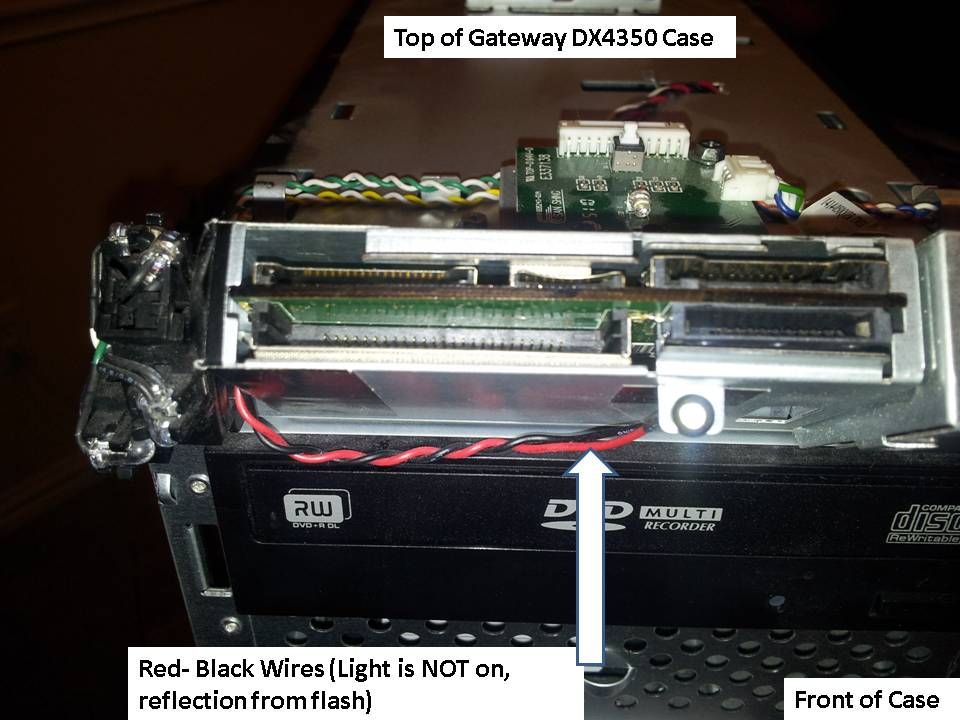

And, I am just guessing that the "red-black" wires go to the Message/Power/Sleep LED from tracing the wires to the front of the case, here is a picture:

Hi, From the picture it seems that green and white go to the power switch and blue and white to the power led.
Not sure about the red & black. Is there another switch / led on the case?
Thank you. I was hoping that would do the trick, but it didn't. The fans turned on for about two seconds and then everything shut down. Just for grins I tried reversing the polarity to the Power LED. Same thing with the fans, but the Power Switch light actually turned on with the fans.
I feel like I am close, but keep missing it. Any other ideas?

No. Disconnect the red and the black wires. The circuit traces are clear. Green and white to the power switch. The polarity does not matter for the switch. Only for the led.
It might be a short issue somwhere else. Try testing the board outside the case.
