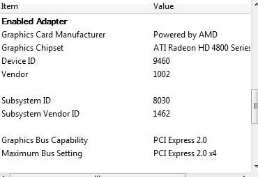

I know the Radeon cards aren't best suited to folding - but I have a 5870 and a 4890 in the same system. I'm using the 5870 in the faster 16x PCI-E 2.0 slot and the 4890 in the 4x slot. There's a third slot even further down and I'm assuming that wouldn't be faster...
Suggestions? Thoughts? Should I use the third PCI-E slot instead?

The specs listed for my MB show it has 3 16x slots and a 4x slot. I think it means 16 lanes but not true full speed 16 lanes? Does that make sense?
September 21, 2011 6:30:35 PM
Ok just looked at your specs. You are right - your mobo has 3 x PCIe 16X slots, but apparently they can only run in x16 x16 and x4.
Basically you shouldnt use your Yellow slot as it's locked down to 4x. If you can use the other PCIe Green slot that should probably help a little bit.
"Having 3x PCIe slots, you would be mistaken to think that all 3 slots support the full bandwidth of PCIe 2.0 specification. While both the green slots do indeed support SLI with 16 lanes on each, the yellow slot is unfortunately is locked to 4x which may hinder performance with the latest graphics cards. The board also supports CrossfireX should ATI be you flavour. On the outset that appears to be the only major difference separating this board from it's bigger brother but as we shall see, there is a little more fat trimmed from the T3eH6 to make it a viable option."
Found this online.
Is this your exact motherboard "DFI LANParty DK X58-T3eH6"?
