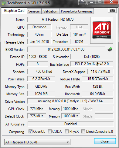

Hi everyone, I recently picked up a Sapphire 6770 Flex edition card and installed it no problems. I used to have two 5670's installed and crossfired fine. Now I cannot get the Crossfire option to even show up in the Catalyst menu no matter what I try. I have tried to un-install all software and drivers through control panel and installed one card at a time, made sure they loaded up and were found by hardware manager and all. Then put on the Crossfire ribbons last. Still no dice.

Catalyst 11.9 installed showing no Crossfire option:
What am I doing wrong here?

I have two cards installed one 6770 and one 5670 both are enabled and show up in device manager fine.

you cannot xfire those two cards together. look at the name in the first post you made. one is redwood, the other juniper. you cannot xfire two different gpu chips. the 5770/50 can xfire with the 6770/50 because they are the same gpu chip.
