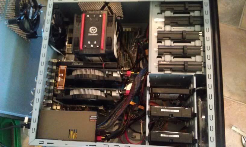

I don't have much of a gap really if you look at this pic it will show you how big the gap actually is
however since this post I have done a few tests I noticed that with the side of my case off it never went above 80c so I'm thinking there could also be to much hot air inside the case which is making it overheat?
I changed the direction of the fan of the side to suck air out instead of push air in and it took a while longer to get up to those temps
okay, now we can see the bigger picture.
1| thumb rule with fans os that for a case like yours we need to have an equal amount of air going into and out of your case. i.e; exhaust = intake
if intake is high then you'll most probably have warm air trap inside and later heat up most components.
2| you seriously need to take a looka t the jungle of wires you have in that case. good cablemanagment is a simple/cheap/effective way to lower temps without any extra leverage from parts save a bag of zipties.
3| have the side intake, the front intake for the HDD's and the rear should exhaust as well as the top fan. though i don't see a fan on the top there, thus the mesh...
i could shoot you some ideas if you'd like?

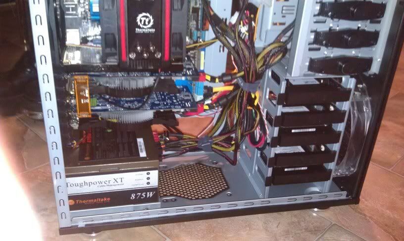

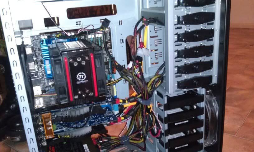

I ended up just carefully taking the board out with the CPU cooler still attached was way easier than taking the whole thing apart just to put it into a new case
I used a cable tie to hold the cable at the top in place and to keep the cable form the fan from moving out of place
I didn't take a pic of the other side but I did cable tie them all together and make it stick to the side of the case
arrrrgh...you really need to do some cablemanagement... :)
honestly go over to the member gallery i posted earlier and you'll get a good amount of ideas to manage all the cables.
the clump of wires on the the front of the mobo should be behind the mobo tray+you have so many options to route that wire around to specific areas to the mobo. Thats the whole point of giving the cut outs on the mobo tray.

when I had the old PSU in it, it was using the cable management like your meant to and it still got hot and the temp got up to 80c with a single GPU
that is one of the reasons I never bothered to do cable management in it and the reason it looked like that, doing it would have given it more room but I don't think it would have made as big a difference as getting a bigger case with more/bigger fans has given me
and also in the new case the GPU temps don't go above 67c
and I went through the gallery I might do some of those ideas
your first shot of your case speaks otherwise since you have an XT now.
Edit;
i noticed you have the XT before int eh centurion but had the fan facing up - that was the key issue - your second and first casrd were being deprived of fresh air cos the PSU was sucking it off.
