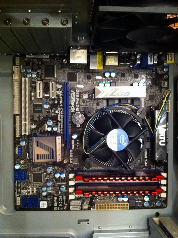

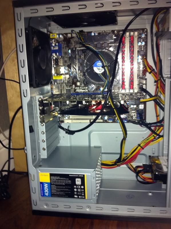

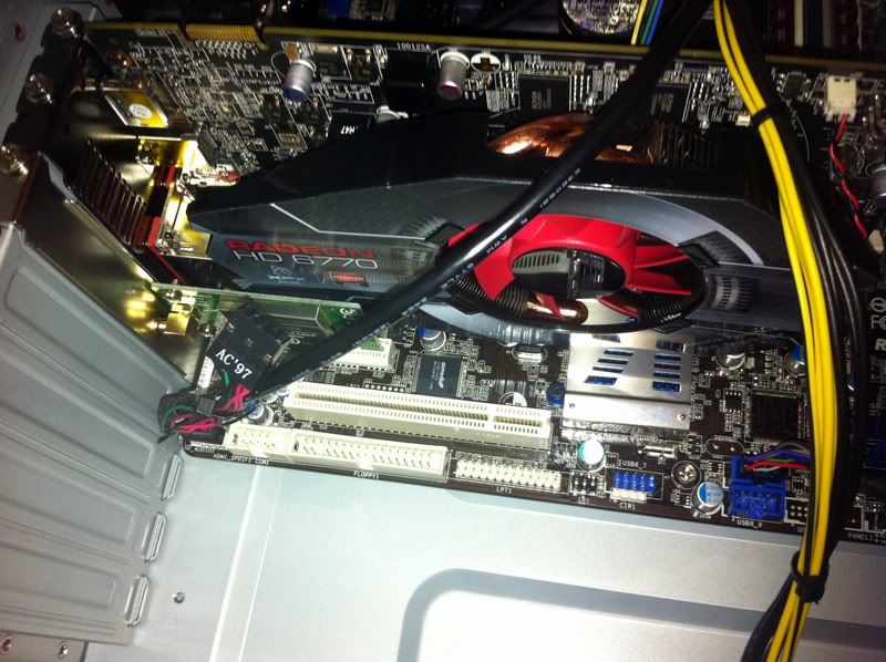

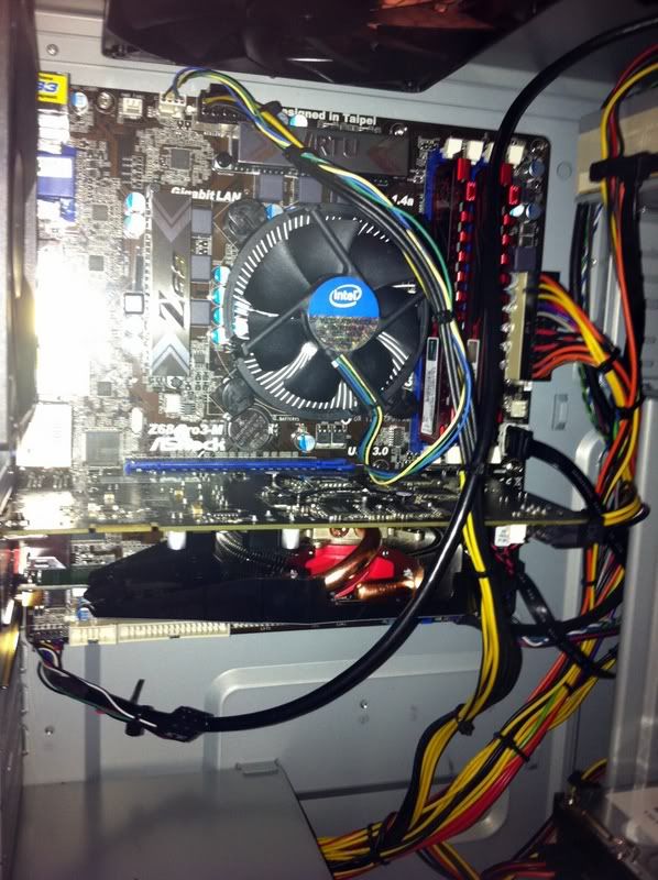

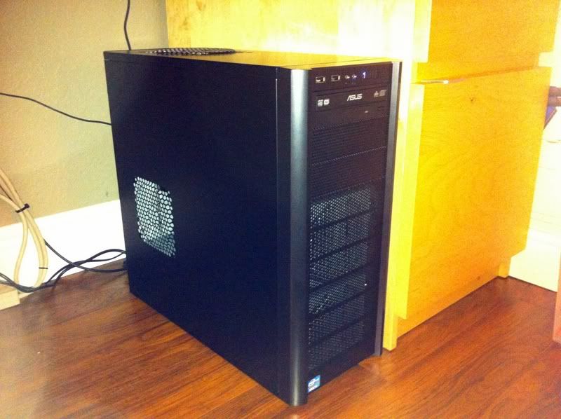

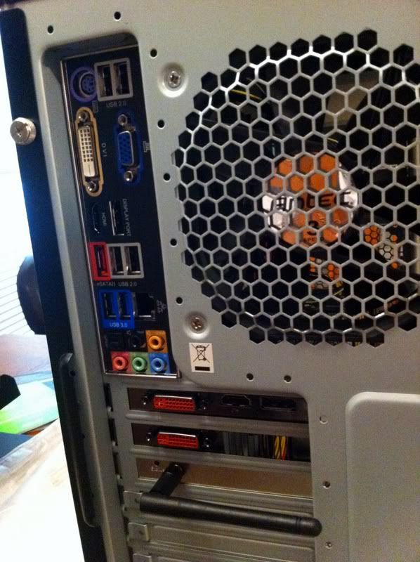

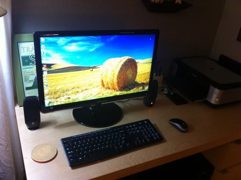

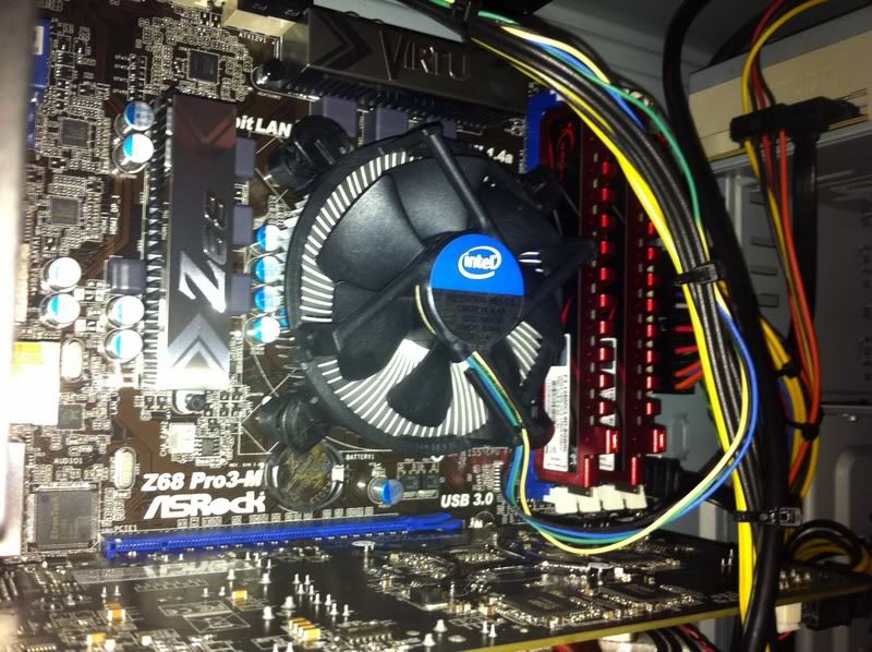

I wanted to come back to this thread and thank all of you guys for your input!
Got all my equipment in on Thursday and had my new computer up and running by Friday evening. I was wrong about the graphics card: I only need one 6-pin connector, not two. Also, I found cable management to be a bit difficult in the Antec 300 case and some of my cables were a bit short for effective cable management. Most cable are pretty much out of the way but the 4+4 pin CPU power cable was too short to go around the MOBO as was the front panel HD audio cable for the case. My main priority was keeping obstructions away form my cooling fans. I know I can get an extension for the 4+4 pin but I'm not so sure about the HD audio.
This machine seems pretty smokin' to me, and I've never had the pleasure of working with such a fast PC. Photo editing for the wife is flawless and I love the fact that I don't have any bloatware to contend with since I installed all of the software from scratch. I don't think I'll ever buy a prebuilt desktop again!
The next modifications will be two 120mm fans for the front of the case and a Cooler Master Hyper 212 CPU Cooler....I'm probably going to buy these this week.
A few pics of the build:
-Wes

I think it is a little late, but if you will be doing a lot of photo editing on that machine, you should consider an IPS panel monitor.
Most monitors use TN panels to display color. The problem with TN panels is that they do not provide for good color accuracy or viewing angles. However, they are cheaper.
IPS (In Plane Switching) panels provide for a better quality monitor with much better color accuracy and better viewing angles.
The reason viewing angles are important is because you will not always be looking directly into the monitor at a perfect angle. TN panels only provide decent color when you look directly at them. When you start to move around even a little bit, the colors will change, although slightly. When you start to look at the monitor at more dramatic angles, colors will be even worse. Try looking at your monitor and stand up and look at the monitor from an extreme downward angle. You will see how the colors do not look the same. This is an exaggerated example, but the colors slightly change at almost any angle.
If you ask anyone who spends most of their time on a computer editing images or video, they will always say to get an IPS panel monitor, and for good reason. You will never find a photographer who suggests a TN panel. The downside is that IPS panel monitors can be a little more expensive.
Luckily, Dell just updated their monitor lineup to include cheaper 23" and 24" IPS panel monitors.
So if color quality, accuracy, and viewing angles are important, I would strongly advise looking into an IPS panel monitor. More specifically, the Dell u2312hm and the Dell u2412m, both of which are IPS and at a good price.
kp texan
Dec 27, 2011
9
18,510
Too late for that now....I'll know next time. If my wife did photo editing for money I would probably go through the hassle of trying to return it but I'll just wait until I'm ready to buy another one. This monitor does have pretty stunning colors with a pretty good viewing angle for a TN monitor.
