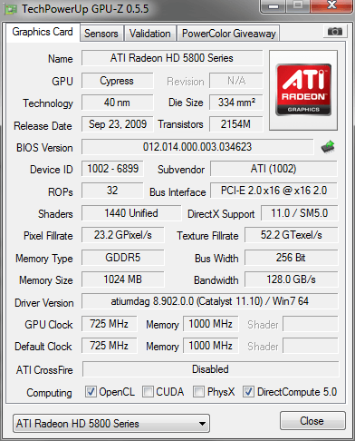

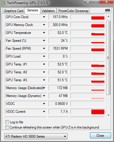

Hello,
Those brown artifacts appearing... They appear for everything. Videos and games and even youtube videos. Just did a clean install of Windows on my PC. Never had this issue before. Tried 2 different drivers. Same problem. I am on ATI HD 5850. Any idea what's causing the artifacts? Both my CPU and GPU is not overclocked and running at stock speeds. Running i7 920 and 6gb of ram. I also remember I used to have this problem before but it somehow fixed itself or something. Can't remember what I exactly did but I am certain I have faced this issue before. Any help would be greatly appreciated.

It's a coolermaster 1000W or higher PSU if I am not wrong. Refresh rate is at 60 and resolution is 1920x1200 on a Samsung 24-inch monitor. I thought it was a dying gpu too when I first got it on my previous installation but somehow got it fixed. Got it again after a fresh install of Windows. On 64-bit Windows 7 by the way. And thanks for the reply :)
I do not see artifacts of the traditional nature on that image. do you have a picture that shows it off real good?
I remember a friend's monitor shows all blacks as bright green. all other colors looked fine. so in some cases the green would look like an artifact, but it was in fact the screen.
Do you have an alternative screen to try by any chance?
look at theses and see if any of them look like yours
http://www.playtool.com/pages/artifacts/artifacts.html
