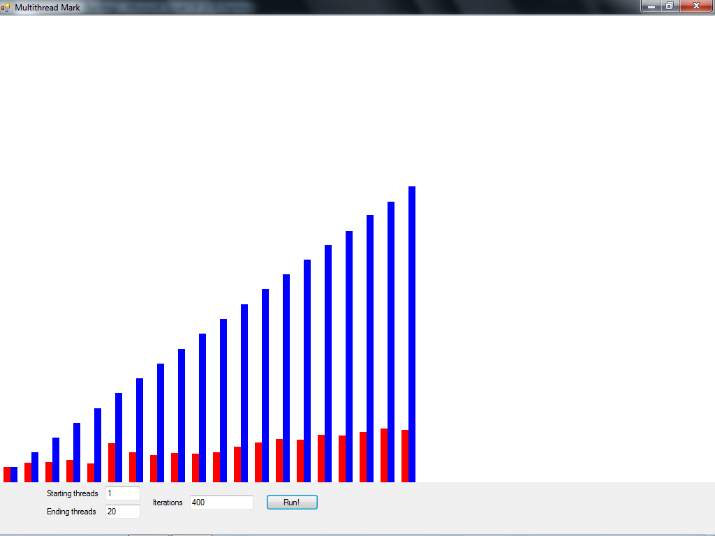

I had assumed that if you plot the speeds of benchmarks, each time increasing the number of threads and the number of iterations , you would see a drop off in how much each thread helps you out after you exceed the number of threads the processor has.
Here is what I got -
Red represents the time it takes to execute on multiple cores, and blue represents the time it takes on a single core.
The blue increases linearly as expected but the red always seems to increase in a "wave" pattern, and it doesn't spike up after utilizing all 6 cores.
I've even tested using 50+ threads and the times stay increasing at nearly the same rate.

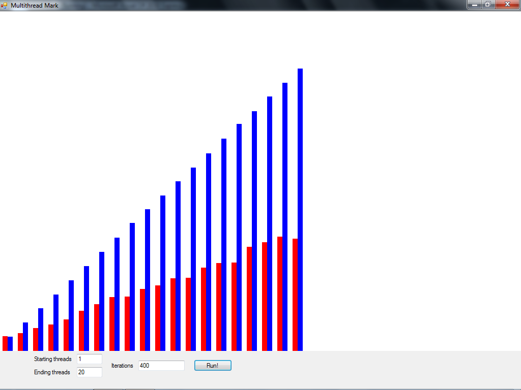

I did the test again after shutting off 3 cores and here is what I got -
The time increased even on the single core tests.
After some other tests I figured out this wasn't a fluke so now I'm just wondering if this is supposed to happen, since I always hear that your applications won't increase in speed unless they're designed to use multiple cores.

The operating system performs a task known as "scheduling" in which it tries to find the optimal method of distributing workloads across available resources. As you can imagine, scheduling has overhead itself.
If the stars all line up properly the overhead will be fairly low, if they don't it will be fairly high. Generally speaking, the greater the number of logical threads the greater the overhead on the scheduler regardless of how many physical threads are able to be handled. However, there are exceptions and this is why your 6 core test has a slight "bump" at 6 cores and a decrease for a bit after that.
When looking at results such as these one has to consider certain aspects of the system in question. Everything from the pipeline architecture, branch prediction, cache architecture, ALU architecture, etc... all play a factor. Generally speaking, each subsequent "core" results in diminishing returns in reality when in theory it should show a 100% increase. The reasons for this are many but one of the largest is that it's very difficult to parallelize the scheduler itself. So, as we add more and more cores we are capable of handling increasingly larger amounts of workloads so long as those workloads are suitably orthogonal to eachother.
Figuring out exactly why is dependent on your 6 core system's setup. For example, if the L2 cache is shared between every two processors then it's nigh impossible to have a 100% gain from adding that second processor because the cache operations overlap. However, enabling a third processor which does not share its L2 cache with the first two processors will increase highly orthogonal performance more so than adding the second processor did.
