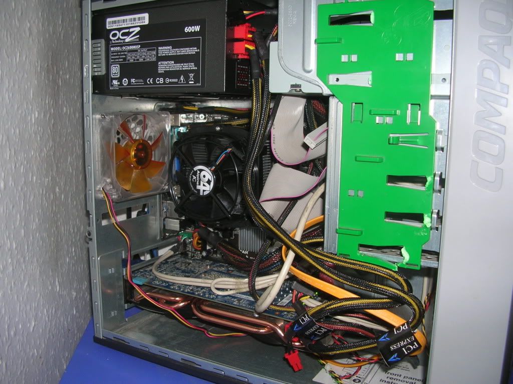

okay
my fan at in my case blows air out of the pc - meaning I feel the air when my hand is behind it, when the case is closed.
so the fan I intend to put on the side.
1 ) Should it blow in, or out , in meaning that when I put my hand next to it I wont feel anything - because it's blowing in. ???

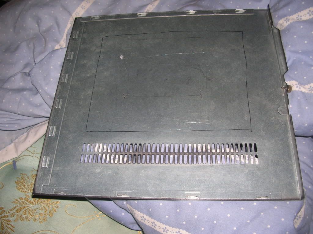

Yes I plan to cut out the metal, put a mesh over it, and screw down a 200mm or 140mm fan.

It should blow the cold air in. You already have fans at the back blowing hot air out.

Side fans generally work best as intake fans. If you are worried about temps you could get a really good gaming case for $50-$60 that comes with fans installed.

The fan at the side should blow in. If you try it the other way, blowing out will give less of a cooling effect to the processor.

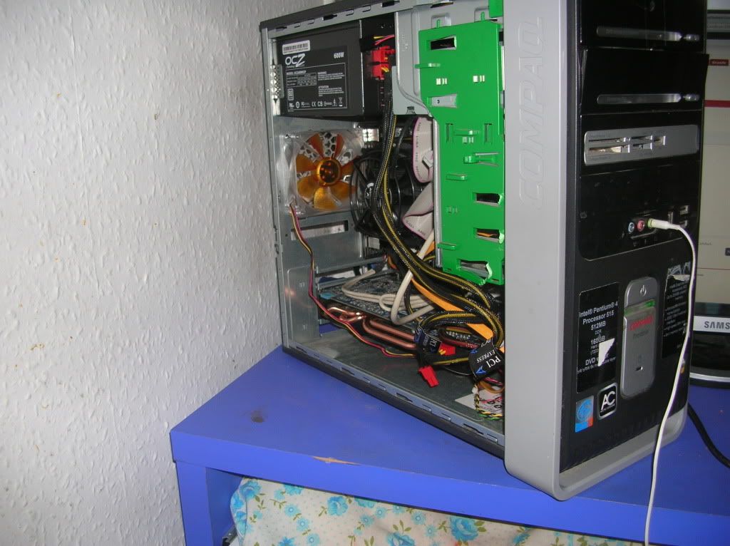

By the look you have at least 3 things blowing stuff out the case...
1. the main fan at back - exhausting air out the case
2. The power supply.
3. The graphics card.
Presumably you already have something at the front sucking stuff into the case?
But as you suggets - another side fan sucking in cool air... escpecially if it focused as supplying cool air to the CPU cooler is probably good.
You seem to have fairly restricted space in the photos... make sure all the air comming in and out has somewhere to go. Dont butt your PC
right up against a wall or anything.
Cheers
January 30, 2012 12:01:34 AM
Front fan blowing in. Supply fresh air to the componets inside and help cool the hdd.
Side fan blowing in, try to mount over your intake of the gpu fan area. Gives fresh air to them hot gpu's.
Back fan blowing out, remove heat from components and cpu.
PSU fan is blowing out.
The real trick on the side fan is not the processor but robbing air from your gpu.
Also, i would mount the side fan lower.
Or, if your handy, get the cpu intake cone and mount that over your cpu instead of a fan.
Usually you do, cold air in the bottom intake, hot air at the top exhaust.
Another thing you could do would be get a tower style cpu cooler. Be a lil better at cooling all your components. :)

It seems a bit difficult to cut the case & install a fan; unless you have the right set of tools. Also don't forget to install dust filter (You can always use a homemade one with sponge), or it will be dust clogged very quickly. :??:
January 30, 2012 12:22:08 AM
You should really consider dumping that OEM case and getting an aftermarket case. They are cheap, usually come with 1 or 2 fans (even more depending on the money you spend), and will cool more efficiently than most any OEM Case.
With all the work you put in cutting and so forth... you'd be spending more. Unless your time isnt worth much. ;p

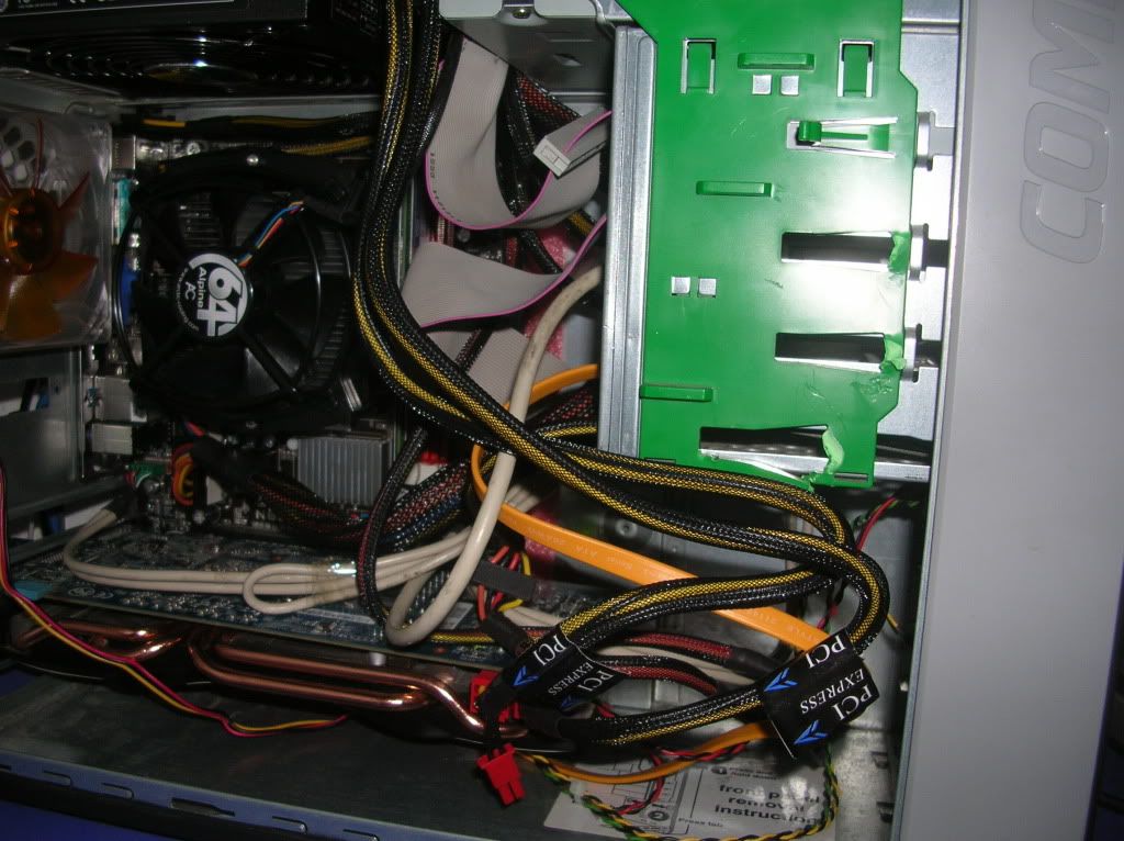

Plus you should really consider redoing your cabling... it looks like a rats nest and definitely cuts down on your cooling efficiency. I've rerouted cabling in cases and have seen a good 5 degree difference.

nope - nothing at the front
everything you see is what I have
at the front I cant, my power button is in the way, the cable is directly in the middle
January 30, 2012 1:19:34 AM
there is no front fan
my case wont fit it

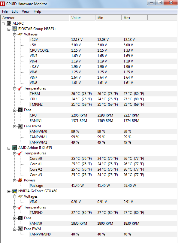

are these good system temps for idle
for intense gaming just double them
January 30, 2012 2:10:40 AM
fairly average temps if you ask me.
January 30, 2012 2:17:04 AM
if you're running at those temps... just clean up your cables... your cables are a mess... which will decrease proper airflow in the case.
