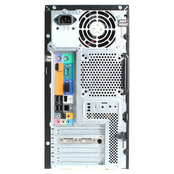

EDIT, i just want to clear this up. Your computer, Is it a BTX type case? By BTX type i am bringing up a question from earlier. with a BTX case the expansion cards are on the TOP of the motherboard on a ATX style case, the cards are on the bottom. And on one of my cases :) its all sideways :)
The power supply is not always at the top of a BTX style case. See how the pci/pci-e slots are on the top?
http://img294.imageshack.us/img294/9357/13atxbtxhc6.gif

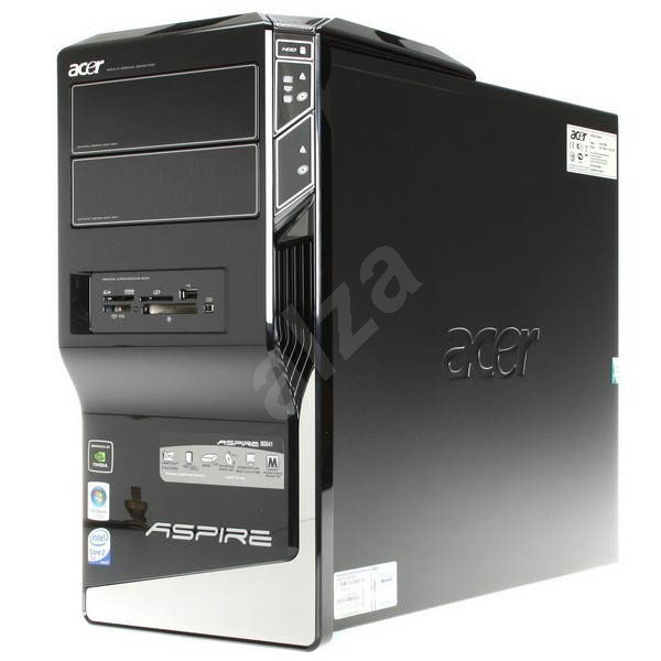

Here is mine:
http://img.alza.sk/ImgW.ashx?fd=f3&cd=TC042o
http://img.alza.sk/ImgW.ashx?fd=FotoAdd&cd=tc042o-03
Why do you ask that? Do you reckon it wont fit?
Reply to dontbugme
I was asking from the same concern as Sunius.
That is good to see, Heat will rise away from your sound card and leave the case.
If it was the other way, heat would rise and hit the top of the case by the sound card and never leave.
Since it is a standard ATX(Technically mATX) cause, you are good.
