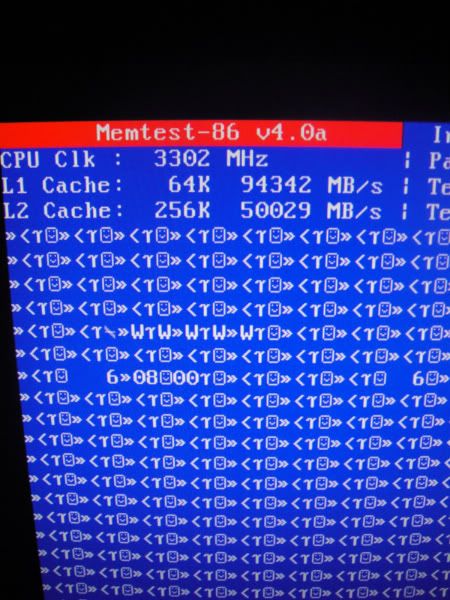

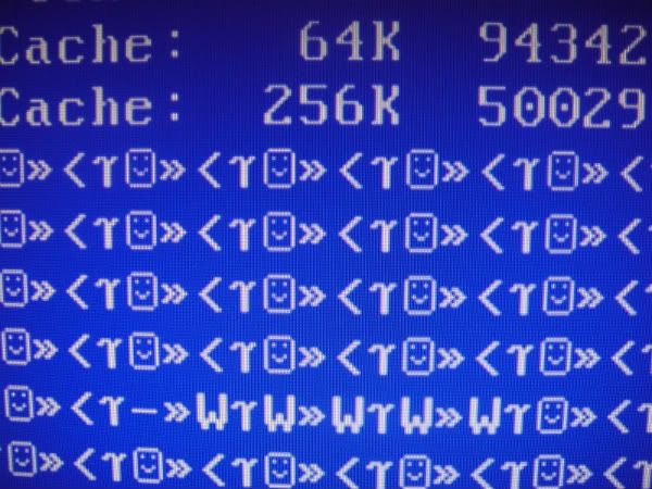

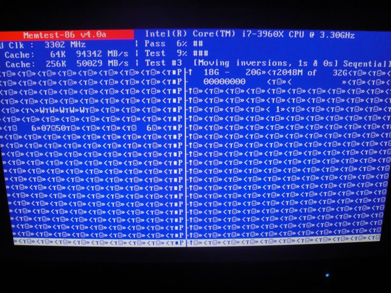

Ill post the photos up of the screen i ran into when i wake up tomorrow.
I got through 7 tests and then next thing i know i look over and i see some of the regular testing text going through its routine numbers and what not but then under and in between stuff and pretty much every where a space would exist theres this weird smiley face. It keep showing <Y[]>> its basically a < then a T with the top part of the T looking like a ~ then the smiley face in place of [] and then a smaller double arrow replacing the >> if that makes any sense lol
never seen anything like that before.... :(
Do post the screenshot, it is interesting to me.
Usually, errors occur as horizontal lines highlighted by red. That it doesn't sound like the case here makes me wonder if RAM is indeed the problem.
I would try to borrow a RAM stick if you can rather than buying anything.
I only heard about this sort of problem a couple times before and I seem to remember that one person said their processor was the problem. That they were able to downclock their processor and it became stable.
Mind you, it could still easily be a RAM problem that is showing itself in the block that is being dedicated to the display during the MemText, and I am still looking with a suspicious eye at that RAM for the reasons outlined above.
Not sure how many people you know that you could borrow a 4 gig stick from, but if there are any it would be a good idea to ask them. If not at least it is only $20 or so to buy a quality 1x 4GB 1333 stick from Crucial or Kingston.

Uh... something looks hideously wrong with that Memtest screenshot, though it's been about a year since I used memtest myself.
As originally stated it appears you're having a problem with the RAM. If possible return to defaults and start tweaking from there. Check what's recommended from your mobo in terms of RAM, all manufacturers release tested configurations, go with what they've tested.
You're not going to damage anything except the possibly the RAM (and only if you've increased voltages too high.)
Your OS may have issues by the sound of it, but after you get your RAM stable you should possibly be able to straighten that out or reinstall from scratch.

So you were kinda unlucky and had both bad RAM and a bad video card?
I can't say it is super surprising.
My focus is on helping people end up with parts that have the absolute highest likelihood of working right out of the box when everything is assembled.
For a lot of people around here, they have no problem suggesting a computer that is 15% likely to have some component fail right out of the box. I would rather get that down to 5%, even if it costs a little bit extra.
Mind you we are talking quality components across the board here, plain bad brand components could push that figure above 50%.
Switch this component for something 2% more likely to work and that component for something 2% more likely to work and it adds up.
Anyway, such is why I suggest Crucial and Kingston RAM, XFX PSUs, and so on.
I don't know how you got the upgrades yourself, but I bought the Windows 7 Professional x64 upgrade through Microsoft's website and they gave me all the files I needed to burn my own upgrade CD.
For Windows 8 or whatever if you decide to switch to a later OS, I would suggest considering doing it that way next time so you can have a full CD around rather than having to upgrade through Windows Update or whatever you did.
Anyway, it sounds like you might be OK if you just keep the old computer's RAM and use the drivers that came on the driver CD with just the good video card.
Let me know if it still gives you problems when you use it in that configuration or if you get a replacement and still have problems.

Thanks, the ram works perfectly fine. My friend was gonna help me out at a later time since we both decided to call it a night.
I ran memtest86 later on with the working GPU and the newer ram and it passed like 2 or 4 times and then some text popped up telling me it passed and to press esc to exit out.
As for the 2nd card im sending it in for a replacement.
