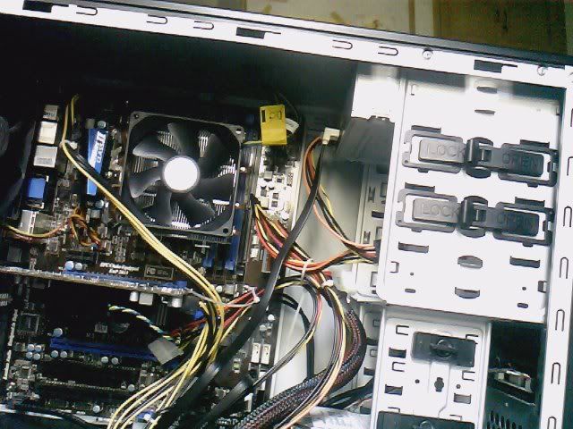

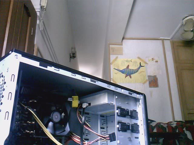

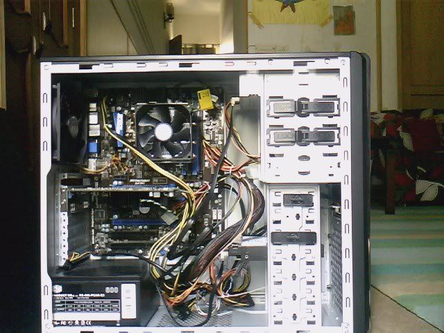

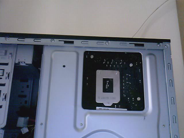

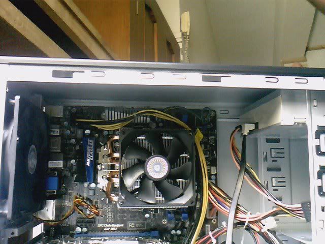

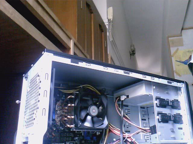

i cant figure out if the cooler is properly mounted, because this is my first ever build and im an extreme noob at this. i took a few pictures with my webcam(handycam N/A). if you guys can figure it out, please tell me if the position is right.
pics:
" alt="" class="imgLz frmImg" />" alt="" class="imgLz frmImg" /> panwala95 said:
it look like a cm hyper 212 +....And if you're right the OP should see a base plate on the base of the mobo, and Coolermaster provide a video...
http://www.youtube.com/watch?v=hSq_xbxsm7Q

Definitely not a 212. If you can work out how the fan is attached to the heatsink and remove it, this would give you access to the four philips screws holding the sink to the base plate. Once removed it is imperative that both cpu and sink surfaces are cleaned thoroughly. Most use alcohol, but you can get a kit which has both cleaning fluids and Arctic 5 paste which comes highly recommended. There are various methods of applying the paste, some examples here
http://benchmarkreviews.com/index.php?option=com_conten...
The object is to apply enough to completely cover one surface. Personally I use a blob about the size of a pea and use a piece of credit card to evenly spread the paste.
If you discover that the heatsink is held in place with push pins rather than screws consider replacing the cooler... The plan is to mate the two surfaces as evenly as possible, and the push pins have been known to fail in this. Hope this helps.
I was thinking that it is unlikely that the temperature of the actual heat-sink is 96 degrees Celsius. There may be a way to easy test for this. Myself, I would touch it, while under load.
Those copper heat-pipes are conductors for transferring from the CPU plate to the heat-sink. It could be either a miss-mount or a malfunctioning cooler.
