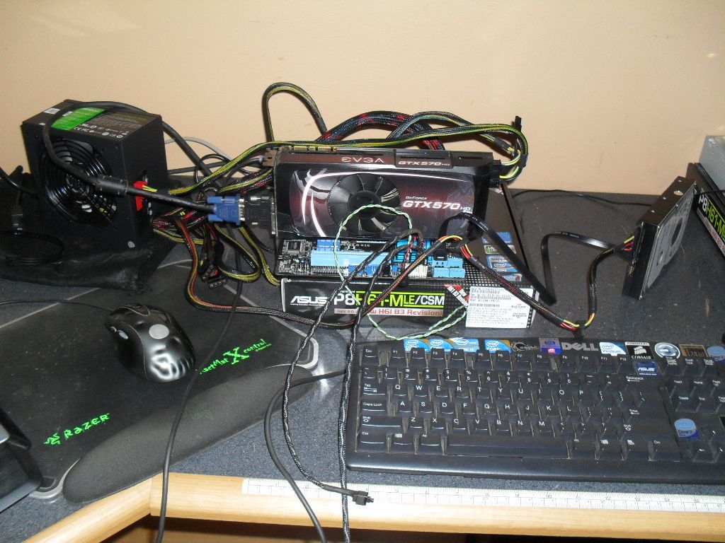

Running Furmark on an I3-2100 with a GTX570 only pulled 300w from the wall ( around a 255 watt load on the ~85% efficient TPN550 ) , the CX430 should be able to handle mining with either of your cards and a stripped system.
Check out the difference in power consumption between your cards and the 570 when running Furmark
http://ht4u.net/reviews/2011/msi_r6950_twinfrozr_2_test...
