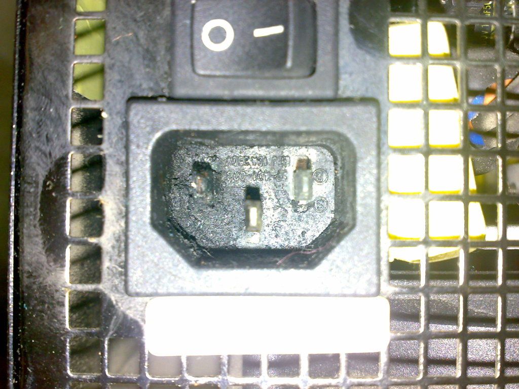

So, this is my friend's PSU.
He bought a new one and gave this PSU to me.
Now, what happen is, my friend said that the power cord he uses is sparking.
And he left it. :sarcastic:
Now, his PSU power cord slot got burnt.
Here's a picture:
Now, I'm wondering if I can still use it or replace the slot.
Any ways? Or, none?
I know that it's nearly impossible.
But still, I want to know. :)
It's okay if it's not usable anymore. ;)

a b ) Power supply
July 12, 2012 10:39:43 AM
is it sparking when it's set to the off position as well? i get sparking when mines on, but that's to be expected

a b ) Power supply
July 12, 2012 11:20:10 AM
You're kidding, right? You're asking whether it's safe to use a power supply that is sparking (it doesn't matter where)?

a c 158 ) Power supply
July 12, 2012 11:27:14 AM
If the plug receptacle is in that shape, then it needs to be opened and electrically inspected, repaired and tested. I wouldn't trust that PSU; a good PSU should detect electrical abnormalities and shut itself down before damage like that occurs. What is the make and model of the PSU?
Edit: It would likely cost more to repair than to replace the PSU.

July 12, 2012 12:03:29 PM
I'm asking my friend now.
Not quite. :)  The sparking takes place on the power cord and I thought that the power cord itself made this happen. Just a thought.
I'm thinking that if it still can be use with that kind of burnt. Can I just remove the burnt particles then use it again?
Would be impossible though. :sarcastic:
Seems so.
It's a Huntkey 500w , my friend said.

Best solution
July 12, 2012 12:06:36 PM
Huntkey = shoddy PSUs on most of their new] units. I wouldn't put this thing within 10' of my PC components after this damage.
