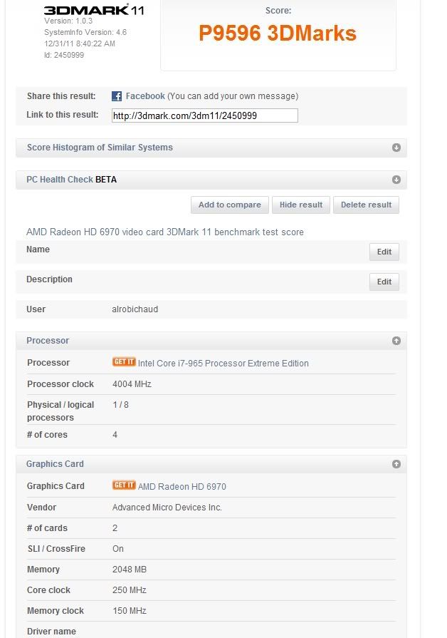

Your scores are accurate. Here is my 6990 running at stock 830Mhz gpu and 1250Mhz memory. You will find 3dmark11 has many flaws. Look at what it reports my gpu and memory clock at. My drivers are also not approved. It also reports my memory as 533MHz which is what the stock speed of the memory controller (533MHz x 2) and I am running 2000MHz RAM. It reports my 6990 as crossfire 6970. I have gotten into many heated debates in this forum in regards to the 7970 being faster than the 6990. Thank you for proving that an overclocked 7970 is still slightly slower than a 6990 :)
