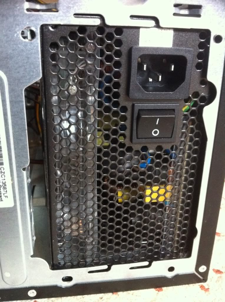

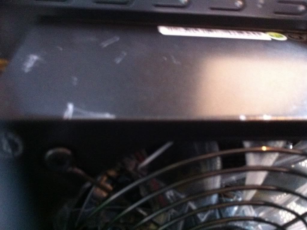

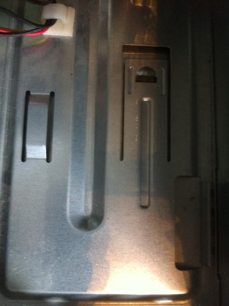

So basically my old PSU in my HP Compaq 6200 Pro Microtower is fitted fine but i bought a £55 FATAL1TY PSU and it fits in the case but not in the like chassis (if thats right word)
Here are pics with some info!
This is current PSU (fits fine)
This is the part where it doesnt fit, it doesnt lock into this part (but fits the case as a whole)
This is the fatal1ty (new psu) failing to fit.. But can as you see fit in the 'Case' not the slot thing
This is showing it is small enough height to fit in the case (not a great pic)
So basically i was asking if there is a way i can make it fit? Do i even need it to fit in this part? can i hang loose? Do i need a new case?

  1. Your best bet would be to buy a new case. Most PC vendors sell specialty parts with their PCs so that you can't upgrade with anything but their parts. You'd best check to see if the mobo has a standard ATX layout as well, to be sure the screws would line up with a different case.

  3. If you can get at least on screw into each side of the PSU that should hold it fine. With the extra space it might create minor air flow issues.

    It just keeps the case from being totally sealed in a place where it should be, so air has a place to escape and cause some turbulence, possibly causing slightly higher temps.

    Pretty much. As long as it's stable enough and held in tightly enough to not fall out, it's good.
  9. As long as you can get 2 screws in you should be fine. The biggest problem with fitting the mainboard into a new case would be the IO plate on most OEM case do not remove so even if you could get the mainboard to fit into a case you would not have an IO plate.

  12. That's a bit of an odd one, first time I recall seeing an OEM like HP actually having a larger than normal power supply. I've seen it the other way round where the OEM power supply has a bracket bolted to the back.
    Depending on you are at DIY, it might not be difficult to make a plate to bridge the gaps. A great suggestion, but if you are anything like me...lol
    Edit...Hmm, looking at the pics again, is looking a bit tricky:(
