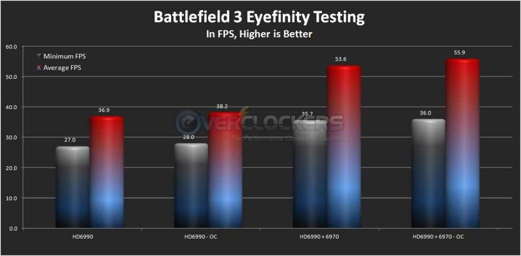

I should know better than to link any benchmark tests here but this backs up what I was saying. Sorry but it is only the 6970. The 6950 is pretty close in specs.
