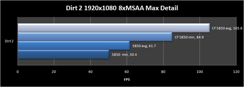

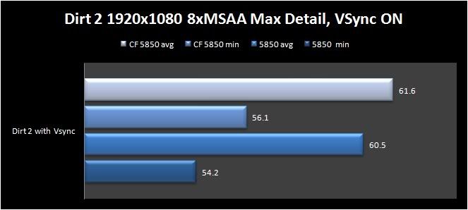

I sort of accidentally benchmarked it:
http://i746.photobucket.com/albums/xx103/Wolfram23/5850%20single%20vs%20CF/dirt2_vsync.jpg
http://i746.photobucket.com/albums/xx103/Wolfram23/5850%20single%20vs%20CF/dirt2-1.jpg
Reply to wolfram23

Obviously. That's not my point. My point is that you will have less input lag and less/smaller framerate drops. The only reason to enable vsync is if your are getting screen tearing (which in my experience BF3 does not have) or you are getting such an incredibly high framerate that it's literally stupid to not enable it (and similarily, it wouldn't affect your min framerate much)
Look at the crossfire results I posted. The vsync ones have a min of 56fps, while without vsync the min is over 80! There's no reason it would dip below 60, ever, considering that, and yet with vsync on it does. And that removes smoothness. So running over 60 fps/without vsync can have a positive impact on overall performance.
Message quoted 1 times
Message edited by wolfram23 on 02-09-2012 at 01:01:12 AM
Reply to wolfram23
