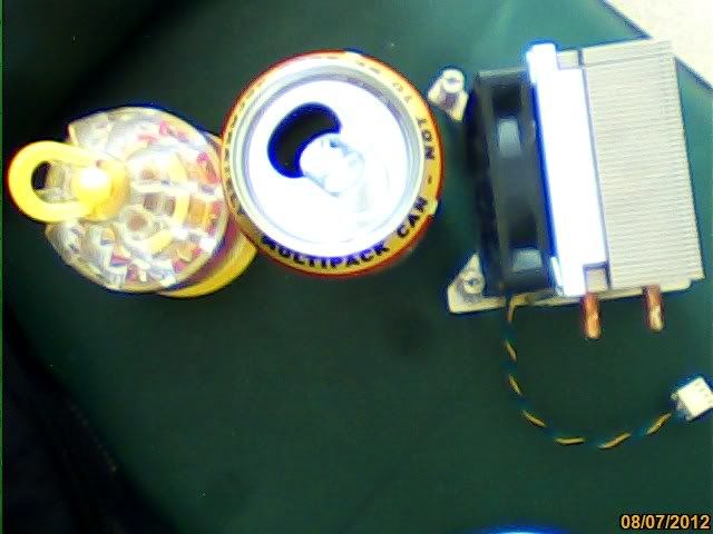

But my heatsink has a 40mm-60mm fan, here are some comparisons between the heatsink, a coke can and a poundland screwdriver kit...
Maybe mine isn't that hot as the die size is 90nm compared to the first prescotts.
The heatsink.
Some comparisons.
Taken with a unbranded webcam thing......
Worse than the HP

That is a newer server heatsink. You can tell because it has screw fittings (seen on servers, desktop units had the $^#&ing push pins), a 4-wire PWM fan and heatpipes (which both came out years after the Prescott did.) That's a much better heatsink than what originally shipped with Prescotts when they were new. It should have no trouble keeping a Prescott cool as most standard-wattage server CPUs have a full-load heat output fairly similar to a Prescott.
All Prescotts are 90 nm. The code name changes when the transistor size changes. A 180 nm Pentium 4 is a Willamette, a 130 nm unit is a Northwood, and a 65 nm P4 is a Cedar Mill.
