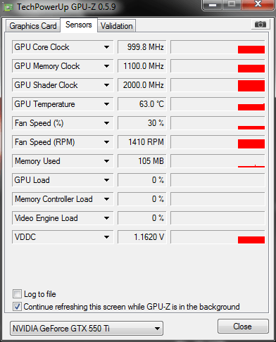

Idle, Fan speed for top card is 1290@29c, Bottom card is 1590@68c.
Top card, under load, 2400@83c, Bottom card is 4200@96c.
Fan on the bottom is indeed speeding up with the temperature.
Edit: Doing card swaps, checking some BIOS settings, and getting GPUz Screenies now.

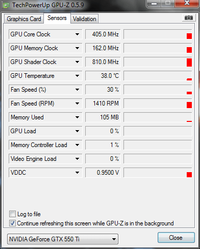

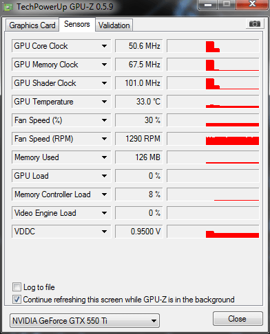

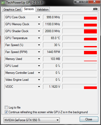

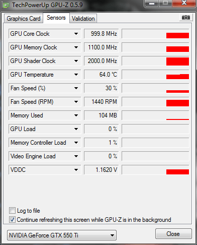

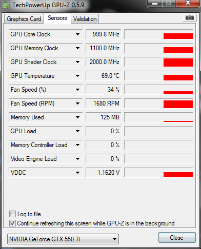

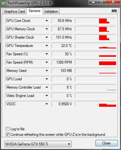

February 18, 2012 3:43:51 AM
Original Problem config.
16x
8x
GPU positions swapped
16x
8x
New card running in Single-GPU configuration.
16x
And, back to SLI config.
16x
8x
The new card worked, still heated up more than the original. But when I placed the older card (confirmed to run at normal temperatures, in the 8x slot for SLI, I got a higher than normal temperature from it, and lower one from the new card. I have tried both configurations swapping out PSU rails, with no noticeable difference according to GPUz... Bios settings aren't indicating different power usages.

GPU tab of GPUz.
16x
8x
Okay, it's showing the bus interface on my second slot as PCI-E 1.1x16.... That's my problem, isn't it...

The cards are both factory OCed, and run hotter than normal versions of the same chipset.
http://www.legitreviews.com/article/1688/12/ Independent testing of wattage used by the AMP cards.
Just realized, the older card is running at a nice, comfortable .950v, the new one is running at 1.162v... Looking now for a way to stabilize the voltage down to the level of the original card.
Bingo! I think you've found the problem. Try using MSI Afterburner.

Although the reason why the card is at that high of a voltage is still a mystery.
Score
February 18, 2012 5:38:54 AM
BTW, 1.162V vs 0.950V is a big difference, I believe the max the cards should handle is 1.150V : / surprising that the cards haven't died out yet.

The newer card is fresh out of the box today. I like my systems to last and be consistent, so I do alot of testing when I first get a new component to see what its capabilities and limits are, it was during the testing that I found the problem, so it's literally got less than 16 hours of use, most idling and rebooting while I've been troubleshooting today.
Nvidia Inspector is showing that even though I'm not running any programs more complicated than my usual monitoring software, card 2 is pinned at 2000Mhz of shader usage, which might explain the voltage draw during idle... Off to find an answer for this question now...

Try setting the clocks with this
And if that doesn't work you can always try the MSI Afterburner.
Score
February 18, 2012 6:36:05 AM
http://www.overclock.net/t/964370/fix-info-dual-monitor-downclocking-fix-for-nvidia-cards#post12719142
This link had a fix, and so far, it's working, Idle temps are down to 40c (still dropping) and 28c, which, considering they're in a mid-tower case, is alright by me. Getting ready to test them under load after a reboot and see how things work.
Another thing that dropped my temps, oddly enough, was plugging one monitor into each card, as opposed to both monitors on the primary card. Who knew, huh?
Have to say, for a company showboating their factory overclocking, Firestorm is a particularly unimpressive piece of software... lol I don't plan on pushing past the factory overclocking, so I'm not expecting to run anything other than the forced-state process in Nvidia Inspector. I'll let you guys know how it goes after some Skyrim... ;)
Edit: Or not.. I just looked at the clock... I'll post the results of that tomorrow... lol.
Score
February 18, 2012 5:57:04 PM
Alrighty, Idle temps are under control. Resting at 36c and 32c respectively, nice and in the comfort zone.
During gameplay (Skyrim, High-Res texture pack running at High settings) It runs smooth as glass, one card in the low 80's, the other heating to the low 90's, peaking at 96c while rendering graphic-intensive zones (transitions with multiple sets of textures, areas with lard amounts of specular lighting). Looking for some kind of load-balancer to split the difference, as the cooler card is running at about 70% usage, the hotter one at 95% constantly. After extended gameplay, (2 hours+) I got flickering on some textures and objects. The card appears to be properly throttling itself back when it gets in that top-end range, but frame rate and rendering suffers.
Fallout: NV presents even more encouraging news. The less graphic-intensive game does not heat the cards as much, 73c and 86c, respectively. This tells me I've got the cards themselves under control, and now need to find a cooling solution. Once again, thanks for everything!
