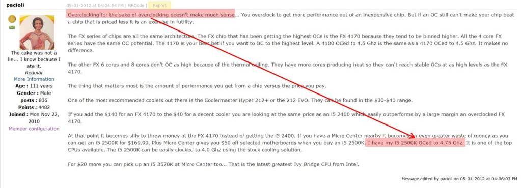

  6. Overclocking for the sake of overclocking doesn't make much sense... You overclock to get more performance out of an inexpensive chip. But if an OC still can't make your chip beat a chip that is priced less it is an exercise in futility.
    The FX series of chips are all the same architecture. The FX chip that has been getting the highest OCs is the FX 4170 because they tend to be binned higher. All the 4 core FX series have the same OC potential. The 4170 is your best bet if you want to OC to the highest level. A 4100 OCed to 4.5 Ghz is the same as a 4170 OCed to 4.5 Ghz. It makes no difference.
    The other FX 6 cores and 8 cores don't OC as high because of the thermal ceiling. They have more cores producing heat so they can't reach stable OCs at as high levels as the FX 4170.
    The thing that matters most is the amount of performance you get from a chip versus the price you pay.
    One of the most recommended coolers out there is the Coolermaster Hyper 212+ or the 212 EVO. They can be found in the $30-$40 range.
    If you add the $140 for an FX 4170 to the $40 for a decent cooler you are looking at the same price as an i5 2400 which easily outperforms by a large margin an overclocked FX 4170.
    At that point it becomes silly to throw money at the FX 4170 instead of getting the i5 2400. If you have a Micro Center nearby it becomes an even greater waste of money as you can get an i5 2500K for $169.99. Plus Micro Center gives you $50 off selected motherboards when you buy an i5 2500K. I have my i5 2500K OCed to 4.75 Ghz. It is one of the top CPUs available. The i5 2500K can be easily clocked to 4.0 Ghz using the stock cooling solution.
    For $20 more you can pick up an i5 3570K at Micro Center too... That is the latest greatest Ivy Bridge CPU from Intel.

  9. Anonymous said:
    I'd really like to overclock though. Which FX should I get though??? I'm not sure which one to get out of all of them (minus the 8 core). Maybe you could also recommend a good cooler/heatsink???
    This was his question. Maybe you missed it...I know it was pretty tough to find, being that it was right above your response.
    So the proper response would be something like this:
    "In my opinion, overclocking just for the sake of overclocking doesn't make any sense. But since that is what you like to do, good luck in your endeavors and you may want to take the advice of some of the other posters in here."
    Or maybe you could have just quietly left the room since he clearly decided he didn't want an intel. Amazing how some people try to push their opinions, even when the recipient isn't listening.
    But wait, there's more! Your post, and stats show that you went and bought an i5-2500k and, wait for it, wait for it...overclocked it?
    Now I think you were that kid in school who just has to have a response to everything...even if it is hypocritical. Thankfully, most people aren't. So enjoy having the last word Mr. Overclocked-non-overclocker.
    P.S. I bought a $30,000 WRX, put about $5,000 in performance upgrades on it, boosted the HP by 50% as proven on a dyno, and although it won't take a $50,000 Corvette on the dragstrip (my 12.9 @ 105 was about a half second off), it will take it in the twisties and on a road course. Besides, I get 24 mpg city and 31 mpg highway, can take all three of my kids for a ride, and have all wheel drive for when it gets a little snowy. So I think I'll continue to overclock, and go spend the extra 15 grand on a new Ducati.
