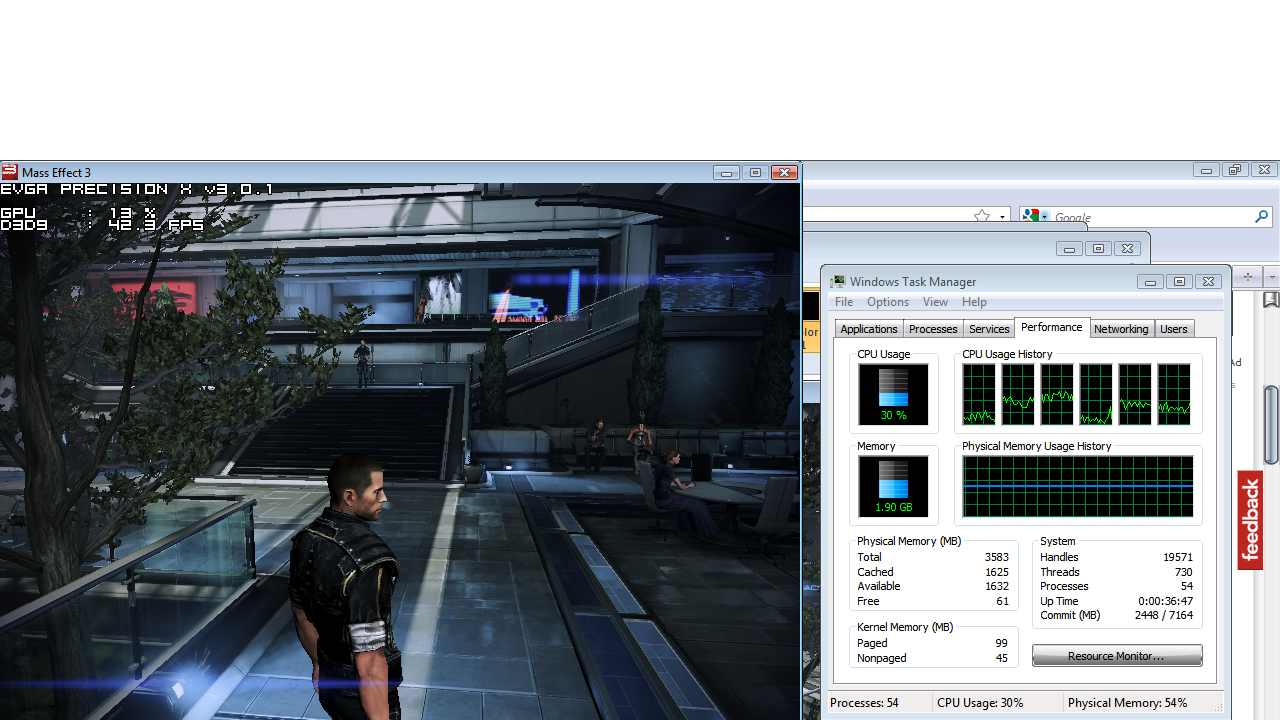

Here is a picture of it in action. https://s3.amazonaws.com/HelixMods/badfps.bmp

My cpu is running very hot but FPS is steady low not spikes. Could this be responsible?

Thanx I think its cpu as well. Its reporting crazy high temps. Thought they were off. I will try reapplying paste and better fan. It claims 150+F!
I think the cpu is fine itself though its not reporting high usage. No core goes above 50% and had 30 usage. I think its temperatures.

when you lower resolution you put more stress on the cpu and when you raise the resolution you put more on the gpu. that is why when you lower the resolution you see no difference. now the gpu can put out more fps because the scene is less detailed but the cpu can not keep up.
I really think its heat though but I will explore all options. I started the game and at the low FPS I looked at temp. it said 180F. I exit game and it drops to 100F.
I will try to overclock if when new fan/paste come in it doesnt get better.
Wow just tried cpu-z. This is cpu throttleing due to heat right? My core speed will go to 3200mhz x 16 multiplier but when I hit a scene that cause fps to drop. It drops to my "idle" core speed 800mhz
