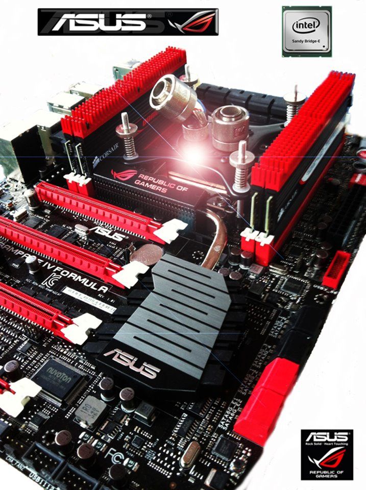

Oh also made a cool Little Photo of my Rampage Formula IV Board using Photoshop. The CPU block on the board in the Photo was just temporary as i use only ekwb blocks. (Hope you Like it ,New to Photo Stuff)
