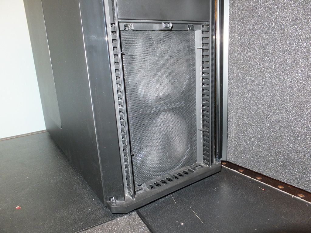

    Speaking of dust, here's a few pictures for you :
    I haven't cleaned the inside of my case ONCE in three months. It's still very clean (my room is fairy dusty as well). The air filters at the front really do make a difference :)
