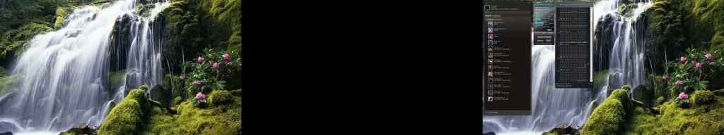

I just checked and my gts470s throttle down to 51mhz when on the desktop no matter what screen configuration I have enabled. In this example I have 2 screens plugged into gpu1 and 1 screen in gpu2. with SLI off.
As you can see in this picture at the desktop both cards are at idle speeds 51 mhz and temps are low.

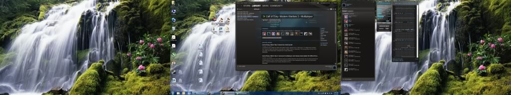

In this example I started MW3 and as you can see GPU1 went to full power 607mhz.
I tried this 10 times in all different configurations, it works the way it should.

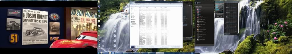

In this example I am running a movie on screen 3 which is plugged into gpu2. As you can see gpu1 is at idle and gpu2 is at 405mhz
In this example i am plyaing mw3 on gpu1 with the desktop and the movie on gpu2. gpu1 is at 605mhz while gpu2 stays at 405.
