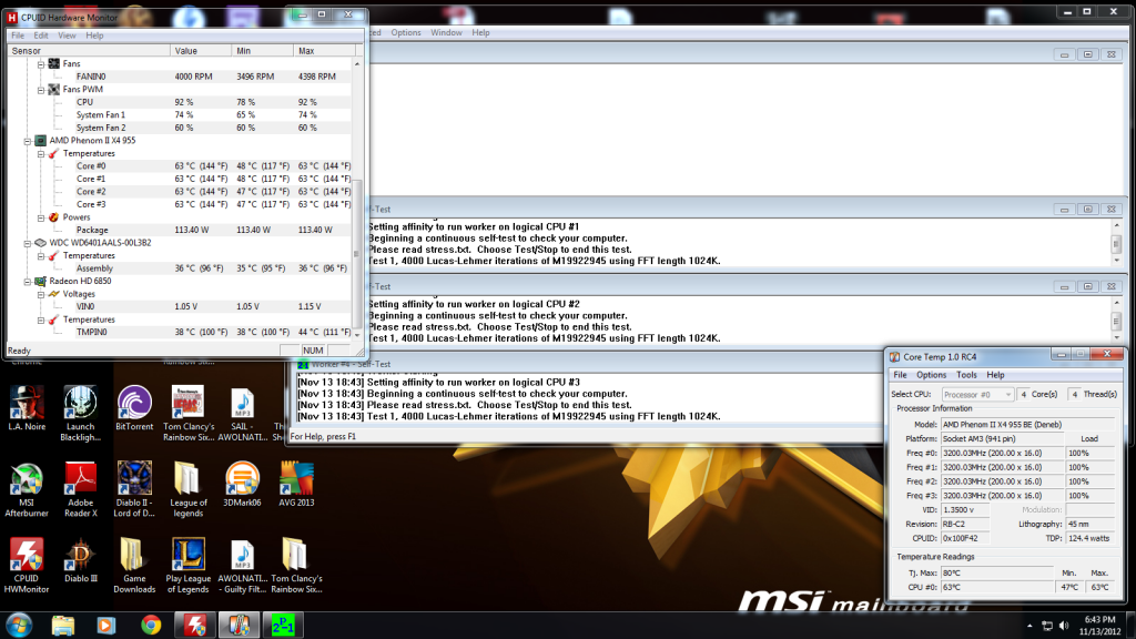

Ok folks I am new to computer building and I am self taught. I built my first computer at the beginning of this year and just now decided to get into over clocking a little. Never had any problems with the system. So i download my core temp, cpuid, and prime. I was a little confused when i saw the idle temps at 50 but I went ahead and ran prime to see how a factory clock cpu would do. The temps climbed quickly(at least in my opinion). After five minutes the temps were right at 80 and proceeded to jump all the way to 256c (i assume this is the max temp the sensor can read). Now I'm no rocket scientist but im sure that thing would be a ball of fire in my case. At this point the cpu throttles back to 800mhz. Of course i stop the test let the temps cool. Under normal gaming (BF3 is the most demanding game I play) the temps go up to 70c. So my question.....
1) IS THIS NORMAL OF THE STOCK HSF? I know prime is an extreme stress test on the cpu and i will likely never put that mush load on it but in my research people are getting idle temps in the low to mid 40s and loaded temps mid to high 50s.
2) IF THIS IS NOT NORMAL IS THIS A COMMON PROBLEM? I have looked around but have not been able to get a straight answer. Some forums saying reapply the thermal paste some saying the fan is bad others saying the cpu is shot and the original poster never comes back to say if they had fixed the problem or what the fix was.

Wow, I would say most of your temperatures were believable but at 256 degrees Celsius? Try running only HWmonitor when doing the prime 95 test. I find it hard to believe the CPU did not shut off at 256 degrees. If it were at 256 degrees I would think that would leave scorch marks. Anyways if you have overclocked then it is reasonable you reach 70 degrees since you are using the stock heatsink.
Anyways I would expect high 50's for a stock heatsink in prime 95 in your case. Also I assume you used the stock heatsink with the pre-applied thermal paste? If so thermal paste is not an issue.

No overclock got the CPU from a friend so I had to put some thermal paste on I put a pea size dot. I have a picture of it how can I post it

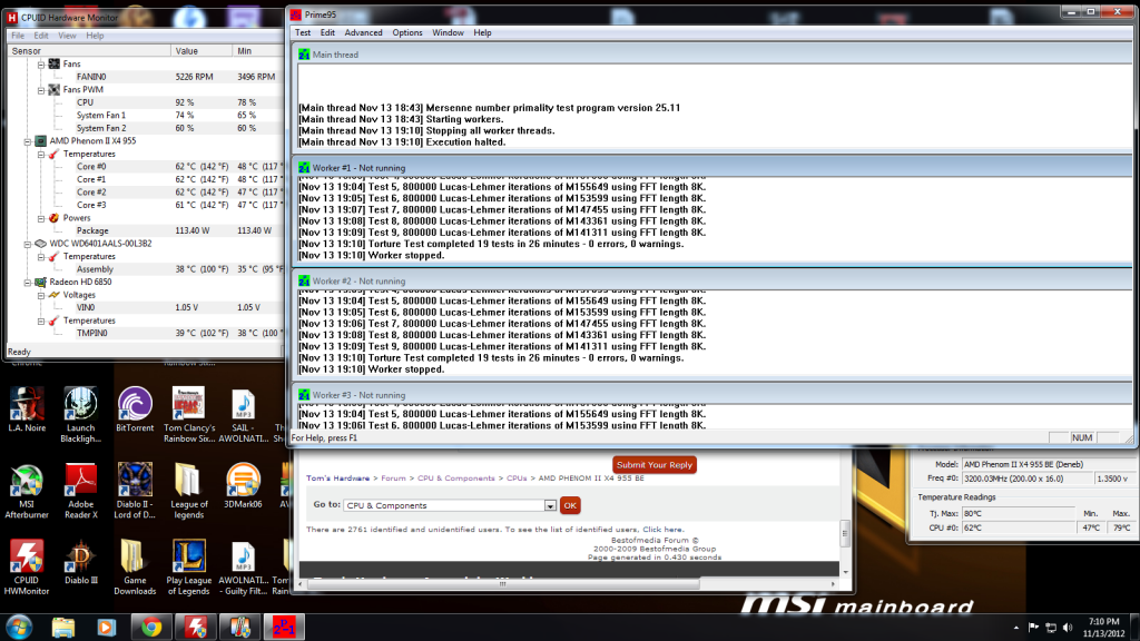

November 13, 2012 11:18:56 PM
just did a bios update only discription it had was it made the board compatible with the new fx cores. Idle temps look the same started prime
26 min later no issues never touched 80c. I still dont like how high the temps are.

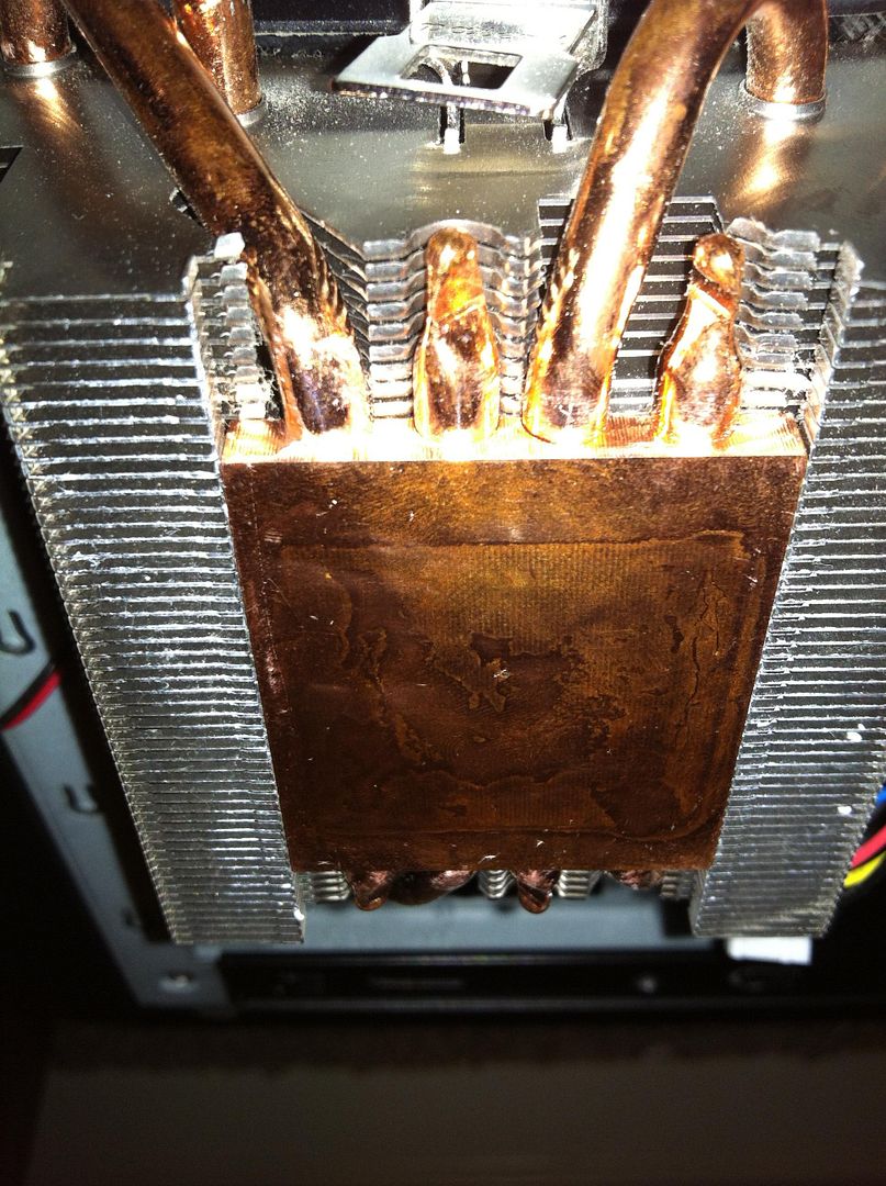

Well does the heatsink have scratches on it or was it damaged? Any bent heatpipes? Anyways I decided to contribute to the thread because I myself am running the same processor with a Kuhler 620, which is equivalent (to me ) to a Hyper 212. Behold these FANtastic temperatures (Get it? FAN-tastic)
Anyways at full load with prime 95 after a night I never exceed 48 degrees. Generally the safe temperature for our CPU is 62 degrees but I believe it throttles much later.
Edit: Does it now say 62 degrees for load with prime 95? If so then that looks a bit on the warm side but the temperature seems reasonable. Anyways hows the noise on the stock cooler? Says its at 4000 rpm which is loud by my standards.

November 13, 2012 11:42:55 PM
While running prime it was between 76c-79c it throttles down once you pass 80c at least for me

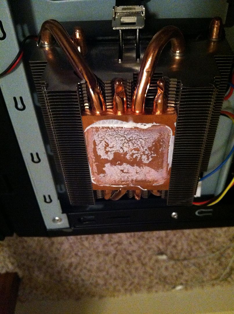

November 14, 2012 11:50:19 AM
took off the fan and it was easy coming off thought it would be a little harder.
HSF i think there may have been an air bubble or two in there. I don't know.
You can see the nicks and stuff with the flash on. HSF is going to get replaced.
Here is the clean cpu. I was going to take a picture of it after i applied the paste but i just got out of work and forgot. But i used some Antec Formula 7. The last time i put it on I let the HSF's weight to spread the paste out. Today I spreaded the paste out by hand(no not literally I used the spreader it came with). Idle temps are still at 50c so time for a stress test from prime.
