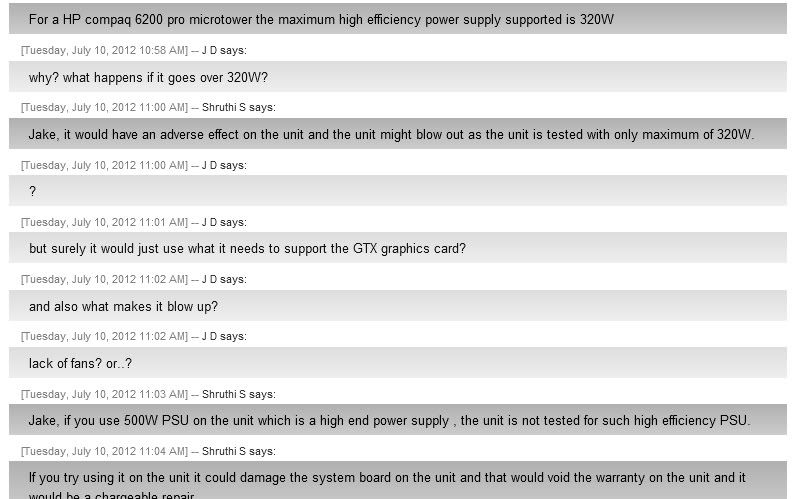

I was still researching after this as well, Mainly because i wanted to be 101% sure before buying £230 + hardware...
I am bumped into the problem of does my PC even support the PSU and Graphics card again, even after DJDeCiBel's repies!
So here are a few screenshots:
This is of the Live Chat (maybe liers) at HP:
Are they right here?
This is out of the manual of the HP product PSU page (dont know if this helps)
So using this information, once again, will the PSU and the graphics card even work in the HP Compaq 6200 Pro MicroTower?
The tech support is absolutely incorrect. The PC will only draw the power that it requires from the PSU. There is no way for the PSU to overpower the PC - that is complete hogwash. The motherboard has a PCIe x16 slot so the GPU will work on the mobo. The PSU is ATX and has all of the requisite power connections; it will provide the correct power to the components in your PC. If it physically fits in the PC then it will work.
