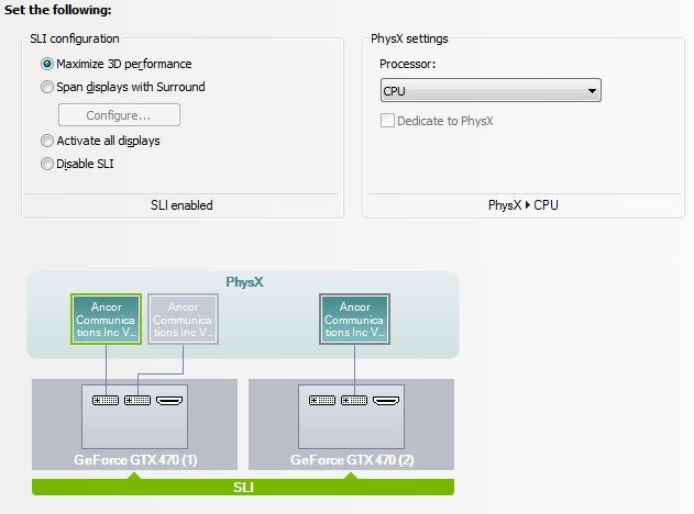

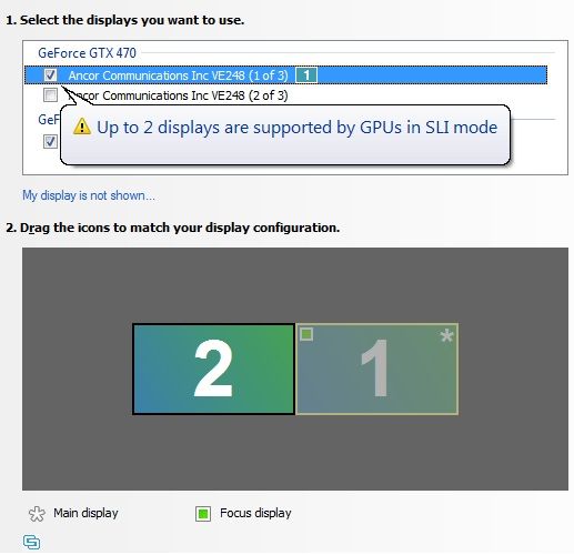

With SLI on... not Surround... (its not the same), the driver gives you this when you try to turn on the the 3rd monitor.

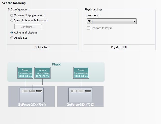

with SLI OFF (activate all displays) you can do this.
which allows you to run the game on the main screen and watch a movie and monitor temps.
The game is in black cause the screen shot was done from windows.
This does not need sli. If this is what you want get the cheapest card you can find.
