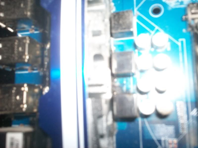

Update here: After finally getting some time to take apart the computer, there is no visual damage to the processor. However, there is a black spot on the motherboard, I'll post several pictures. I'm assuming this means that the motherboard is trashed, if there is no charring on the processor, would the processor still be okay? And does this rule out the PSU as the issue or could that still be what caused it?

Looks like your board might have blown a capacitor (can't tell, the second to last pic is a little fuzzy). A bad PSU might have caused it, or it could have just been a board failure--capacitors do fail now and then. I've only had a power supply fail once, and my processor was okay. Also, look closely around your ram slots and pci e slot(s) for charring.

After inspected the board a bit more, I couldn't find a blown capacitor. They all seemed to be in fine shape. It could be as Darth said - the board couldn't handle the extra voltage for such a prolonged time, but how could I go about testing to be sure what parts are failing on me. Specifically the power supply. I don't want to get a new board, and potentially a new processor, and have that blow because the power supply was failing on me.

It looks like somthing fried/shorted out. From this point I would start trouble shooting by replacing the motherboard first and see what happens. If everything works after you replace it than you know it was just the motherboard and everything else is fine. If it still doesn't work after you replace the motherboard than something else fried too and you will have to do more trouble shooting.
