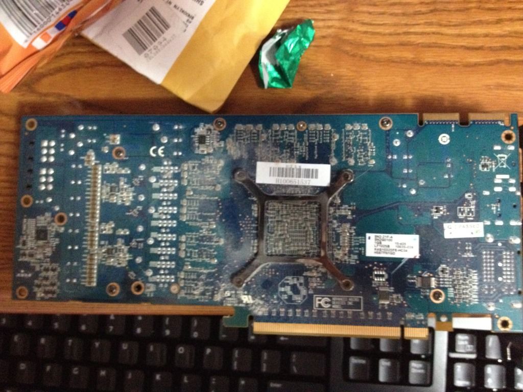

Hello, everyone!
I need to replace my GPU fan on my Radeon HD 5870 made by HIS. It has iCoolerV on it. (idk if that information helps.) How do i go about replacing this fan? What kind of fan do i need? If anything additional may facilitate this process, please tell me!

EDIT, also check to ensure your current board is a reference design. look at the back to ensure it is similar to this. You want everything to line up.
make sure the hold line up and all that good stuff.
http://www.ixbt.com/video3/images/ref/hd5850-scan-back....

Will the fan be able to fit on this? some of the holes are not lined up.

my card says " HIS HD 5870 iCoolerV"

HIS used a custom board for your card.
That it self is not a problem at all, just that AC makes a heatsink for the reference 5870 card. The other one listed works on many cards and should cover yours.

July 12, 2012 3:09:33 AM
As long as the video core is not to close to the rear ports then yes.
Looking at your image and the reference the gpu holes look right.
In is also important to use any heatsinks that come with the cooler for the power system and memory if needed too.
