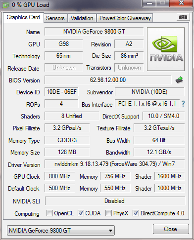

Hello,
I recently bought a new video card i installed it and installed the latest drivers (304.79) it supposed to have 1024 mb of vram but windows say 128 mb dedicated video memory and Gpu-z reads the same 128 mb and it also give me a very low specs as the bandwidth is only 8.9 Gb/sec ! and texture fillrate is only 2.2 G BUT iam sure that the card have 1024 mb becuse when i press the power button the pc turns on and on the screen i see nvidia gf 9800 Gt ..........
1024 mb of ram and then the windows start
also notice that i installed the card and a new ram at the same time
My system:
Cpu Pentium Dual- Core CPU E5700 3.00 GHz (oc to 3.315GHz)
Installed Ram : 2*2 dual 4.00 GB (2.97 usable i think its also related becuse when i uninstall the video card the ram well be 3.47 usable) .
PUS 450 w
OS : windows 7 Enterprise 32-bit
Please HELP me

I think that the card is damaged, this is a 256bit card and only one fourth of that is active. If it were fully active it would read 512mb if the 128mb per 64bit were correct which matches most green editions anyway. Take the card out and look for anything broken or missing. Beyond that if I were you I would try to get my money back asap.

hay guys , i have nvidia 9800 gt green but i dont know why my video card spec and performance is too low see gpu-z below can it be proplems with the bios configraion? i only get 76 points in FurMark .
also note that installed the video card and the ram at the same time and i heard that installing the ram and the video card can lead to such problems ....... .

    January 5, 2014 5:34:25 AM
    Oh man! It is just the wrong driver. That is all it is. When I did a fresh windows install back when I had my 9800GTX+ GPUZ would read almost the same thing 64 bit mem bus ect, It just takes a older driver, I know the latest drivers work with the 9800GTX+, But the 9800GT is different (funny) my friend had a 9800GT before I gave him my 9800GTX+, And he had to use one of the older drivers it was version 195.62 ,
    But that's all it was, I hope you did not hurt anything taking your PC apart, I have no idea why someone would tell you to pull out your ram sticks, (That was crazy and had nothing to do with your GPU, Maybe he was messing with you) But I know this was long ago, But if you still have that pc? This is the driver that will do the job 195.62 http://www.oldapps.com/nvidia.php?old_nvidia=16?downloa... You would think the driver would have been the first thought hu?
