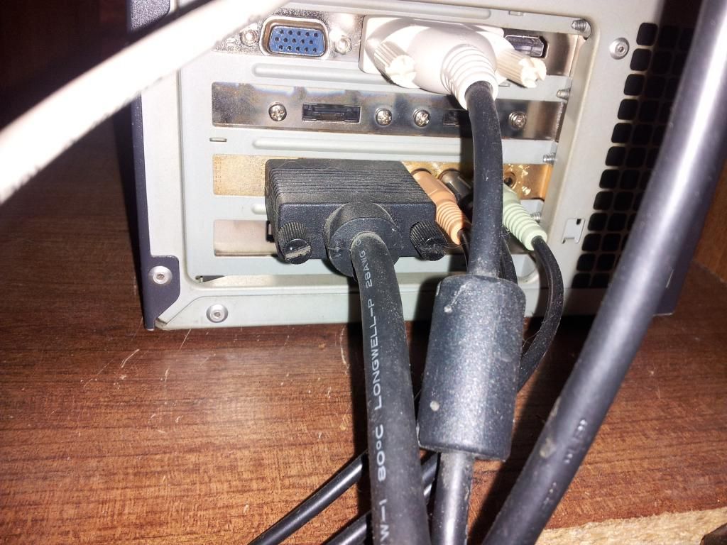

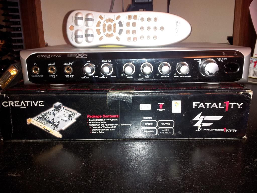

This is mine.
Plugged into the card.
The original Sound card box.

Idonno said:
Then Unfortunately she doesn't have a clue. You need to get a hold of someone at Creative that does.You can click on any of these images to make them bigger if you need to.
Yup that's exactly what I've got except I'm missing a cable. Right I will wait and see what she says and then if she still plays stupid then I will maybe try and phone then up. I will post be posting updates as I go along with them
