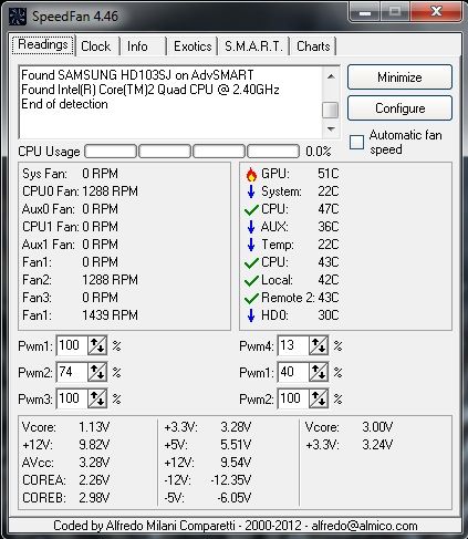

At this point, the GPU was listed as 50 or 51C, which was the highest thing. The main CPU heat would dip to upper 40's and turn green, but the GPU would not drop below flame icon. I went ahead and decided to play a game and take a screenshot of the heat at that point. So....in the middle of the game, I tab out and see this:
CRICKEY!!!!!!!!
So......I shut 'er down and pop out the video card. I try to open it up, but this video card isn't easy to get into . I'm able to open it up (mostly), clean out the dust, and replace the thermal paste. So, it all seems the best that I can do, but when I boot it up, I still see this when it's just idling.
What can I do? I know as soon as I start playing a game it's going to freak out again. Even at idle it's pretty hot. What can I do? Maybe I should even ask.....what can I do THAT IS COST EFFECTIVE?

It's not that bad, those 'older' cards often idled around thse temperatures, try running a game with GPU-Z running, it's a free app and will continue to log temperatures if it's left running in the taskbar.
The CPU idle is a little high, though, check those **** pushpins have locked fully into place it's a known issue with this design.

OK....the last picture was when the Prime95 was running. It did shut itself off not long after that.
I did boot it up and was playing a game. It didn't shut itself down, but I did capture these results during my play testing. It was only 15 min or so.

IMO your GPU temps are fine. GPU's can get hot and generally do. Your problem lies in your CPU. If I'm looking at your picture when you were running P95 correctly, I'm not familiar with speedfan, your CPU temps are WAY too high. Plus I can see BF3 in your background, which is a CPU intensive game.
If you had seen random video glitches and artifacts, which you haven't mentioned so I'm assuming you haven't seen any, that would hint to GPU issues.
I would suggest check airflow to your CPU and check your CPU fan for proper speeds. Also make sure you have enough but not too much thermal paste and your CPU heatsink is sitting properly on your CPU.

Have to agree there, the card seems to be running fine but those CPU and system temperatures are well above normal.
With the system off, remove the side panel and check the rear fan is clear, dust can clog the blades and vents and it's often difficult to see if the vents themselves are clear.
Boot up and check the fans are turning, it's not unknown for monitoring software to misread so a physical check is warranted.
If all else is fine, I suggest you remove and reinstall the CPU cooler, I've had this with a 775 build myself, I was convinced the pins were fully seated but they were not and the system shut down less than a minuet after booting up.
BTW, make sure all the old thermal paste is removed, even small traces can prevent good contact between the CPU and cooler. Computer shops sell cleaning fluids or you can use pure alcohol-no, not Vodka ;) .
