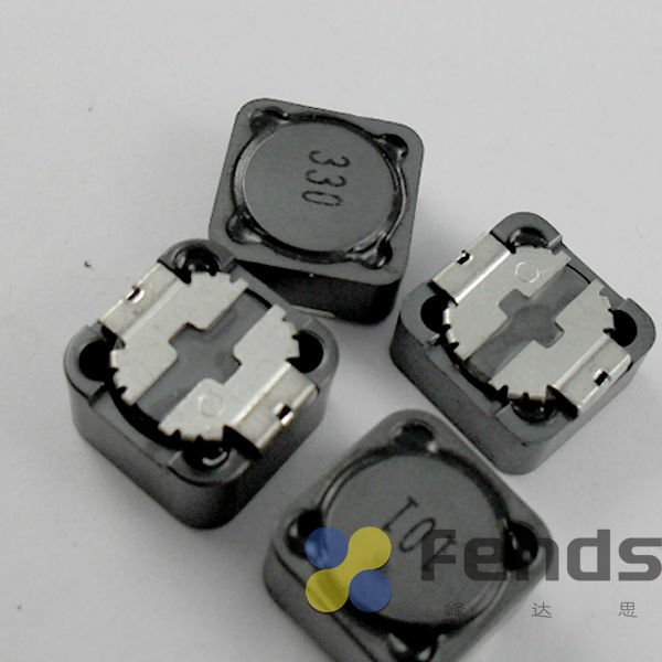

What are those little Gray box things next to the mosfet heatsink? I think burnt my finger on them. Also if I stress test long enough my cpu will throttle, even though it didn't get hot enough to. Are there any better coolers for the mosfets or should i back down on overclocking a little bit.

those are the caps that I said put a heatsink on. Technically speaking they are covered (capped) inductors.

30C is often below the temperature of the computer interior, and I've never seen a MOSFET rated for less than 125C. Even the CPU is rated for at least 65C and the DRAM for at least 70-85C.
Do not install heatsinks over the capacitors since the thin metal and lack of good contact will result in little heat conduction, and the heatsinks will block the vents of conventional electrolytics, possibly creating an explosion hazard.. It's much more reasonable to install heatsinks over the MOSFETs.
The inductors are not capped. Those are their cores. I don't know if heatsinking will help, but I've never seen heatsinks used on inductors.

Really? Might want to look at some 990 fx boards, almost all of them are heatsinked, pretty much any high end board for that matter.
The thing is if you looked at the extreme3, you can't heatsink the capacitors without heatsinking the covered inductors.
This is what they look like if you removed the cap on the inductors.
Here is the underside with the copper coil installed in the cap, packaging varies, but they are near identical on the inside.
