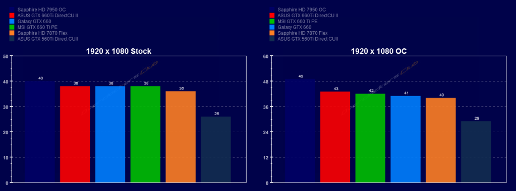

A friend of mine in a different thread asked me to compare my OC'd 7870 with benchmarks for a 660ti. This is what I posted for him:
Other cards stats are from: http://www.overclockersclub.com/reviews/nvidia_gtx_660t...
This chart you will find on the link above:
My results for stock clock were very similar to the HD7870 on their chart. I have a Sapphire HD7870, they tested with the FLEX model. They score 36, I scored 35.7.

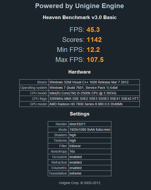

Now when I move my clocks to 1300/1525 this is my result:
It's a little higher than their result. But theres no telling if they reached the limit on their card or were just doing moderate overclocks. Overclockings are very subjective to the hardware and not all cards of the same model will overclock the same. I think it's a toss up and really depends on what games you prefer and what is on sale at the time of purchase.
