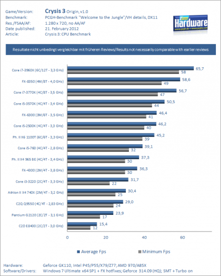

Let's take a look at Crysis 3 since it is new and I was able to find a CPU comparison chart as follows:
Source: http://www.pcgameshardware.de/Crysis-3-PC-235317/Tests/...
The Core i3-3220 @ 3.3GHz can get 31.7 average FPS. The Core i5-3570K @ 3.4GHz is only 100MHz faster, but the average FPS is 50.5. That represents a 59% increase in FPS; or 18.8 FPS. The 100MHz difference contributes a very small amount of that increase (like 1 FPS out of the 18.8 FPS). A quad core is clearly better.
The problem with i7-3630QM @ 2.4GHz and the i5-3380M @ 2.9GHz is the 500MHz difference. That's basically a 21% difference in clock speed. Naturally, that means you will not be getting a 59% increase in FPS, but something less. A rough estimate is about a 46% increase. That's calc'ed by 59% * (100% - 21%).
When you play games that only use 2 cores, then the core i5-3380M would perform better simply because of the higher clockspeed. Skyrim will run better on the i5-3380m, it will be less than 21% though (the % difference between 2.9GHz and 2.4GHz) because clockspeed does not scale perfectly in the real world.

The 1st part is right. If you buy the quad core I7 3630QM you will generally get rough performance increase of 46% compared to the dual core i5 3380M. At least based on the comparison of desktop CPUs,
But you are wrong on the 2nd part. For games that only uses 2 cores the i7 3630QM will have lower performance than the i5 3380M simply because of the 500MHz difference. In Skyrim the i5 3380M can potentially give you up to a 21% increase in performance because the cores are clocked higher. In other words, the i7-3630QM is about 17% slower than the i5 3380M in games using only 2 cores due to the lower clockspeed.
