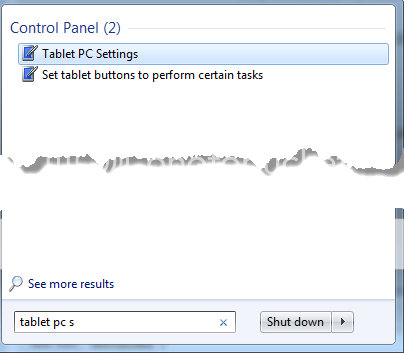

Sorry, not sure why it's acting different for you. I don't even have to type out the whole phrase for it to work on mine, as shown below in the screen shot:
I'm running Win 7 Pro 64 bit if that helps.
Edit: PS I'm running a typical desktop, not a tablet.
