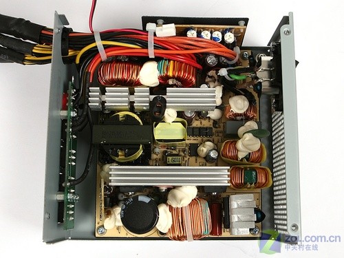

Hi, that psu isn't that good that's what i'm saying the rosewill green is a good choice.
See here a review of a based model as the antec : http://www.xbitlabs.com/articles/cases/display/asus-psu...
http://power.zol.com.cn/119/1198279.html
Same internal parts.
The first two are clearly not the same PSU as the third (just looking at the internal pictures shows that the first two are not the same as the third) and the third rated it highly and I quote from Google Translate "Internal workmanship is absolutely the first class". I fail to see your point.
Also, I'll add to that by saying that having the same components (assuming that they do) doesn't mean that they're the same quality if they aren't manufactured the same, which they clearly aren't. For example, some RAIDMAX PSUs have top-notch components, but are put together like crap and run much worse than some well-assembled PSUs that have inferior components.
Hi, you're in denial, the two are the same, both made by delta, the pictures show it, the antec bp 550 plus is a low end psu , it has in fact 32A on the total, it's really low for a 550W psu, it's a budget psu made by delta.
It doesn't mean it's a crappy psu, but it's not better than the rosewill green, but it's still inferior, i rather get the rosewill psu.

Better to be in denial than to be wrong about the specs, mister "it has two rails +12V rails". Also:
Obviously not the same layout. I'll also take this opportunity to mention how Delta makes some of the best PSUs available. They're no Seasonic, but they make some excellent units.
EDIT: I just noticed the price went up and it's now only $55 with an MIR, so it's not the same price anymore (must have changed very recently because I was looking at it a few hours ago and it was $55 without an MIR).
"+3.3V@28A, +5V@26A, +12V1@22A, +12V2@22A, +12V3@25A, -12V@0.5A, +5VSB@2.5A"
It has THREE rails for +12V. Furthermore even if its the same internal parts, that doesn't make it the same PSU. For example, RAIDMAX's 1000W Gold PSU has better components than most of the Bronze and Silver 1000W models by better companies, yet the shoddy assembly still makes it perform like crap. Components are only part of quality and one of your reviews, the one that's actually about it, explicitly states "first class workmanship".
Yes, the three rails, correction, it's usually a typical thing from delta, but it's way less than 40A in the total, the 2.2V has 32A.
The asus has the same internal parts and made by the same make(delta) : http://www.tomshardware.com/reviews/power-supply-oem-ma...

Yes, the three rails, correction, it's usually a typical thing from delta, but it's way less than 40A in the total, the 2.2V has 32A.Each of the three rails would need to be limited to less than half of max load to run at your predicted 32Amp number. They can go to at least 2/3 or 3/4 of max altogether. Besides, the BP-550+ is rated for up to about 44amps altogether on the +12V rails (states right on the box that it is rated for up to 534W total on the +12V rails), aka about the same as that Rosewill Green 530's rating.
Also, there is no 2.2V rail that I've ever heard of and if you meant 3.3, then IDC what it's rated for because it doesn't matter.
Furthermore, I know form my own use of the BP550+ that it can in fact go to at least 38Amps on the +12V rails because I've tested several units in several builds at that load.

I mean it's the ATX12V 2.2 version.
Just get it, that psu is a old model, and it isn't that good compared to some of the other psus around, and it's the same as the asus, so that review is valid.
Maybe you should do a review of it ?

Unless that Corsair model is a V3, I suggest against using it. The V2 CX/Builder series models have bad caps and the V1 models has all sorts of issues.
properbuilds said:
I mean it's the ATX12V 2.2 version.Just get it, that psu is a old model, and it isn't that good compared to some of the other psus around, and it's the same as the asus, so that review is valid.
At the least, their layouts are very different and that's not to even get into the potential for assembly differences. Besides, if they're the same, then why does your third link (the one that's about it) praise it so much while the first two (about a an Asus model you claim to be the same) don't?
blazorthon said:
At the least, their layouts are very different and that's not to even get into the potential for assembly differences. Besides, if they're the same, then why does your third link (the one that's about it) praise it so much while the first two (about a an Asus model you claim to be the same) don't?The review doesn't praise it in the electrical performance, this all started with this :
blazorthon said:
I'd recommend going for the Antec BP-550 Plus over the Rosewill Green 530 for the same price (well, it's technically a few cents more expensive, but practically the same at just under $55). It has better reviews (both professional and customer) from what I can tell and the advantage of being modular for the same price is nice.Where are the reviews in the first place and what makes it better than the rosewill green ?
So i just showed it's not.
properbuilds said:
The review doesn't praise it in the electrical performance, this all started with this : Where are the reviews in the first place and what makes it better than the rosewill green ?
You did not show me that it's not better. Quite the opposite, in fact. The whole review that you gave a link to about it had nothing but praise for it.
http://www.eggxpert.com/forums/thread/323050.aspx
EggXpert's list has the Antec Basiq models listed as higher quality.
Some of the best PSUs are made by Delta as shown here.
As for consumer reviews, the Antec has fewer failures on Newegg despite having many more reviews in total and has a somewhat higher satisfaction rate. Also, the BP550+ is modular whereas the Rosewill Green 530 is not.
I'm still looking for my other links (it's been a while since I looked up this PSU) and if I find anything more, I'll also provide them.
Regardless, if still you're that adamant against it, then w/e. The Rosewill Green 530 is still a good model and there are other options too.

It's just that some try to change the psu for worse, and with more expenses.
You can always change for another like this one(this should end the discussion), it's a seasonic oem unit : http://pcpartpicker.com/part/xfx-power-supply-p1550sxxb...
