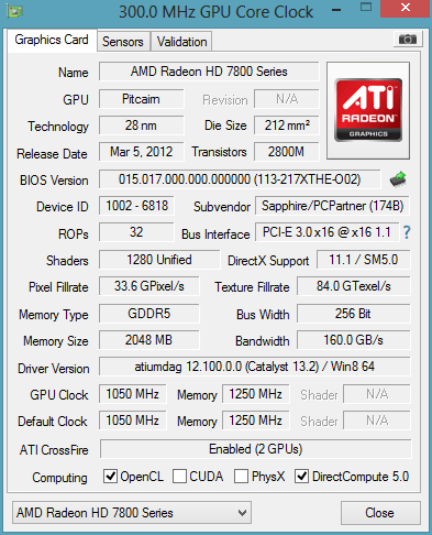

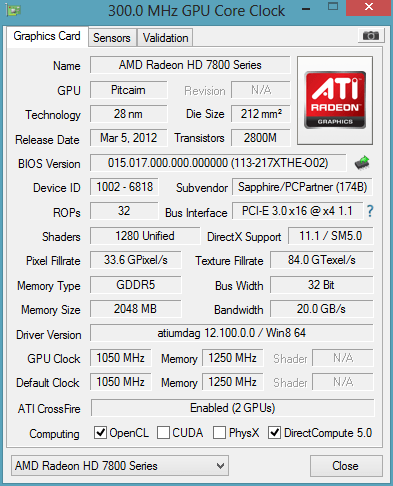

I've noticed that GPU-Z shows that my cards are connected to PCI-E 3.0 x16 @ 16x and PCI-E 3.0 x16 @ x4, although in my mother board manual it is said that I have 1 PCI-E 3.0 x16 slot and 1 PCI-E 2.0 x16(x4) slot.
January 25, 2013 10:26:48 AM
The two cards will still perform better than one, but would do a little better with x8/x8 slots. There is a review floating around here somewhere showing the difference between slots and basically 3.0 x4 is similar to 2.0 x8. You really aren't losing a ton of performance, maybe 10%. If you want to check performance just do a quick benchmark in a game that has it with crossfire enabled/disabled to see the difference.
