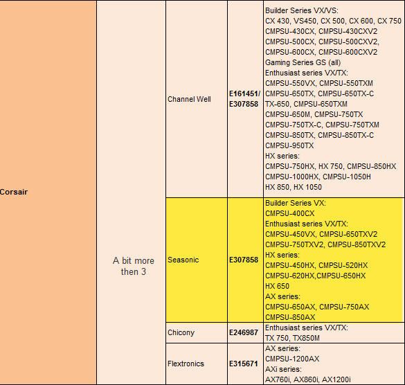

Well, I hate to break it to you but a lot of what Corsair makes is Seasonic based. There is a tier list that newegg has placed out which should help you kind of decide a brand/series that is good for you.

bigshootr8 said:
Well, I hate to break it to you but a lot of what Corsair makes is Seasonic based. There is a tier list that newegg has placed out which should help you kind of decide a brand/series that is good for you. http://www.eggxpert.com/forums/thread/323050.aspx
Actually Seasonic only makes 3 current Corsair power supplies.
i understand seasonic makes alot of psu's for different vendors. unfortunately the corsair units ive been coming across havent been doing well, thats why i brought it up.
They still make a good amount of corsair power supplies. And a bit more then 3

bigshootr8 said:
They still make a good amount of corsair power supplies. And a bit more then 3http://i98.photobucket.com/albums/l249/bigshootr8/1-30-20132-33-59PM.png
http://www.tomshardware.com/reviews/power-supply-oem-ma...
That list includes discontinued models no longer produced. The RealhardtechX site is much more up to date. They pretty much do daily updates. Even when new lines are announced but not released yet they have them listed.
anort3 said:
That list includes discontinued models no longer produced. The RealhardtechX site is much more up to date. They pretty much do daily updates. Even when new lines are announced but not released yet they have them listed.still I would implore you to find less then 5 of those power supplies for purchase. because it doesn't matter whether or not they make it or not anymore but whether or not you can purchase it.
