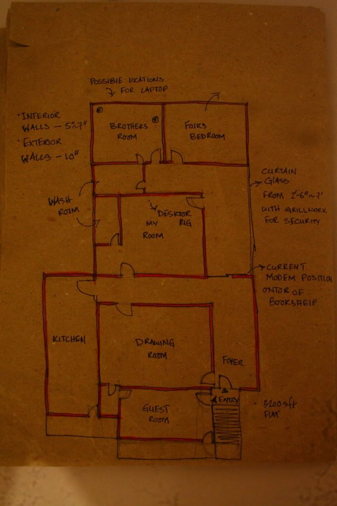

  8. Okay here you go emerald mate!
    Rig 2 in member config, this is located in my room
    about distances:
    *from the current modem position to my bro's room is less than 50ft, if its a straight shot :)
    **have furniture upto waist level and have the curtain glass with metal grill work inside
    *** i apologize for the sketchy layout - my bro was busy and i had to do a mock up quick, while being resourceful :P and its not to scale - well not the rooms atleast.
    **** the modem is hooked to desktop via cat6 cable (maybe 70' of it). modem is from a wifi ISP.
    hope these give you all the info you need.
    Lemme know if you need anything else.
  9. There is no guaranty but you should be okay placing the new router in the same location then the old one.

    you will need a IP enabled phone to be able to check for wireless networks.
    no matter where you place the router your room will be okay
    the current location might be the most central to accommodate the guest and your brother.
    another good spot could be in your room to the left of the door when you exit towards the kitchen.
