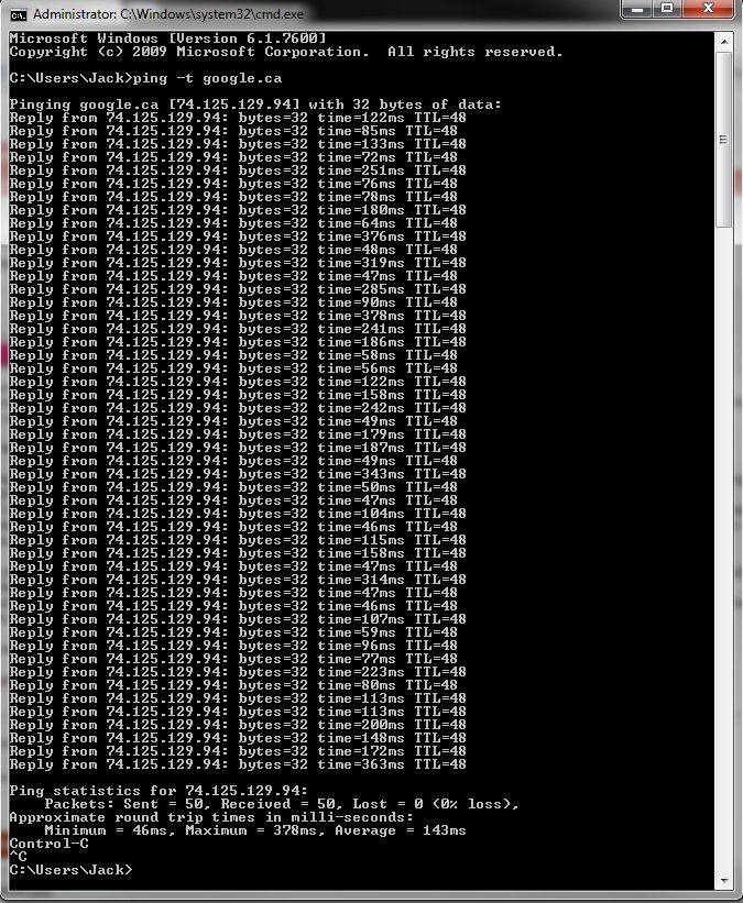

As of now, this is what a regular ping test looks like.

    Upon more research, I tried disabling the routers firewall.
    Take a look.
    This is with WiFi still enabled, and disabling didn't work as well as I originally thought. Still got a few high ping times.
    Theres gotta be a solution to this. I would assume keeping a router's firewall on would be vital to security. Is keeping it off an option?
    EDIT: After leaving firewall off for a bit, i'm still getting high latency spikes. S#!t!
  3. Problem is PING does not actually test just the network it also tests the end devices you are pinging...and even your own PC. Processing a ping request and generating a response has low priority compared to other processes so many times you can get delays or even drops when the end devices is busy.
    You really don't NEED a firewall in a home environment. Mostly because NAT is stupid and does not know where to send traffic coming from the internet your internal machines are protected.
    Gets tough to prove it is your router doing this. First I would ping the internal ip address of the router at the same time as the remote address. You would think if the router itself is busy it would delay pings to both. I would also see if pinging your ISP router (ie gateway the router uses) makes any difference, this would eliminate a lot of network since 30ms can be many miles away.
    Beyond this you would need to insert something between the router and the modem that could see the traffic. This is advanced so I will leave it at you would insert a tap or switch mirror and capture the traffic with a packet sniffer like wireshark. The key here is you would capture on the pc sending the ping and see if you can detect the increase in time as it goes into the router and it leaves.
